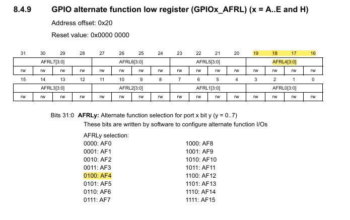

    > GPIOB->AFR[0]|= (1U<<18);
    This sets AFR for PB4 to 0b0100 = 4, that's not what you want.
    MarrkinhoAuthor
    October 13, 2024
    This is a reference of the datasheet. The reset values are 0's hence, I am trying to SET pin 18 and leave the rest to 0 as highlighted. Not sure what  you meant by saying that's not what I want ? Any further explanation would be helpful . Thanks
