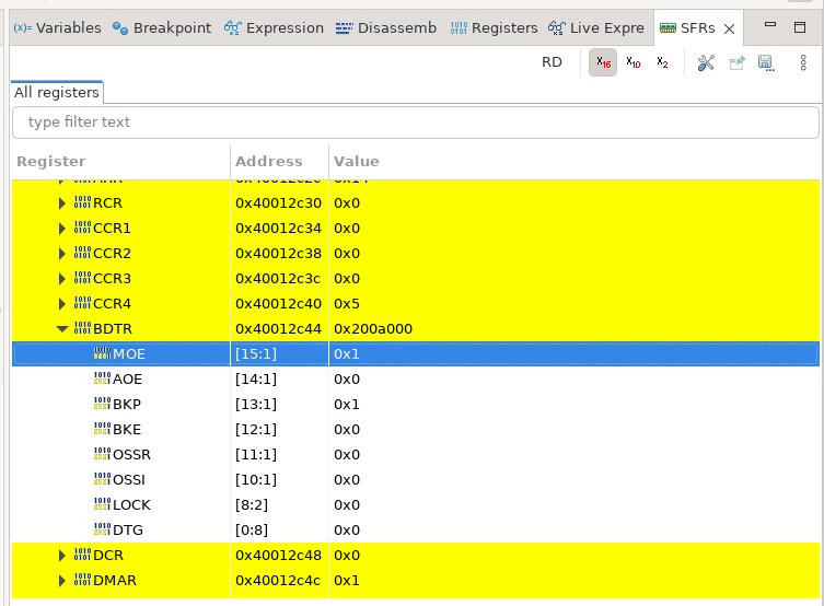

I don't use Cube but TIM1 is an Advanced Timer and needs TIMx_BDTR.MOE to be set.

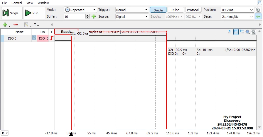

Just to verify that PE14 is operational i once more (typo PE15 in original post) verified my setup for measurement, and it seems fine.
As far as I understand the MOE is set with the PWM project.
waclawek.jan
March 21, 2024
Show all Timer and relevant GPIO registers content.

@PeterL , you set timer to 80/20 -> 4MHz output, with 5 ticks pwm, 60ns pulse.
But set pin to low speed, -> set high.
And set debug not to disable, if you want to debug.
