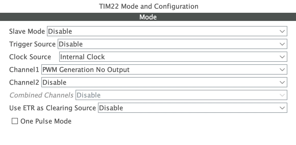

I am using STM32L052K6T6 with a passive buzzer is connected to PA6. Idea was to use TIM22_CH1 as PWM output to feed the buzzer. However when I get to configure PWM on this port, only relevant looking option is "PWM Generation No Output" and indeed the pin does not seem to be outputting any PWM waveform.
I might be misunderstanding something, what does PWM Generation No Output means ? I checked the Datasheet several times, and there is no difference on specs between this channel and others. What does it mean a pin being assigned to PWM but not outputting ?
Is there a way for me to get PWM output from this pin (aside from bouncing the pin manually on every timer interrupt) ?

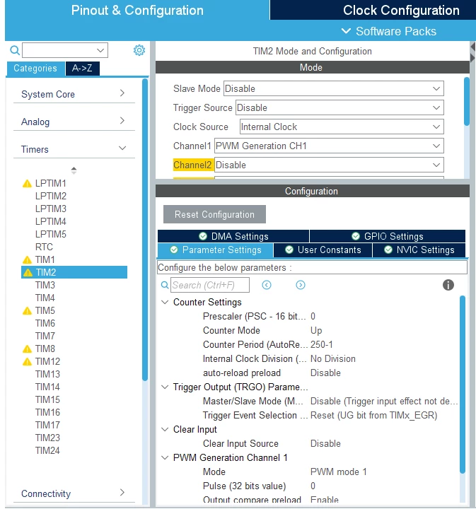

To make a pin a PWM signal, you must enable the Timer, select a channel to be PWM Generation and set the counter period in parameter settings. See an example below of the settings (using the STM32H723)
Next, the code has 2 parts. First, you must start the timer. For Timer 2, channel 1, I use the following code (I've added the HAL_OK check, but you can remove that):
if (HAL_TIM_PWM_Start(&htim2, TIM_CHANNEL_1) != HAL_OK)
Error_Handler();
Then you must set the Duty cycle. Otherwise, there will be no signal on the pin and just a flat line. This can be done will the following code:
TIM2->CCR1 = 50;
TIM2 is the timer, CCR1 is the channel (channel 1), and 50 is the duty cycle %.

Hello, @KSOdin2  thanks  for the detailed post. I did all of this. Only difference we are having is on Timer setup this is what I see:
For Channel 1 yours reads "PWM Generation CH1", mine reads "PWM Generation No Output". Question is what is the difference and why.

Ok sorted, this was a UI problem as @waclawek.jan suggested and adding
HAL_TIM_PWM_Start
as @KSOdin2 made it work. Thanks for everyones help.
