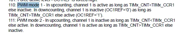

Hi, I'm studing STM32F4.
I'm looking at pwm mode in timer, and I wonder if there's a difference between using pwm mode 2 and using pwm mode 1 to invert using CCMR1 register.
