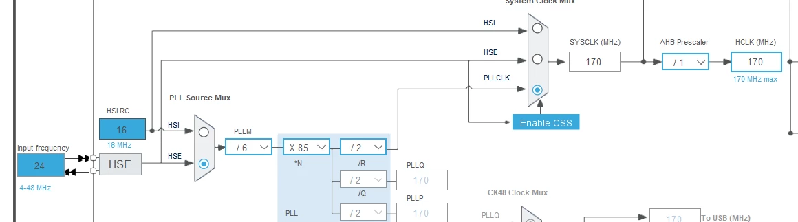

The Nucleo G474 has an external XTAL please use it, hopefully it will improve accuracy,
configure Crystal/ceramic for HSE as follow:
Select HSE as input for the PLL and enter 170 in HCLK:

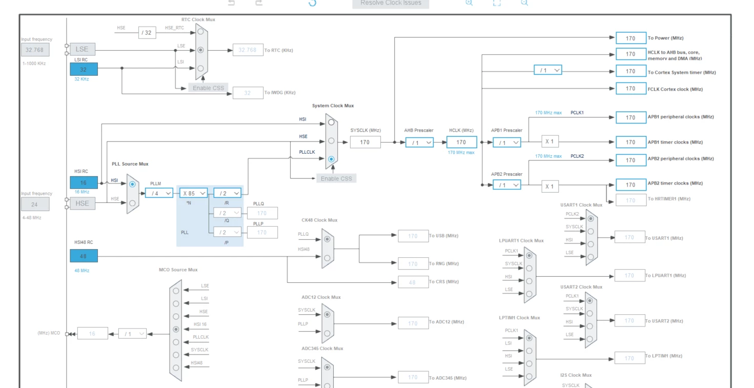

What clock are you using as source for the PLL ?
EliazLBAuthor
May 16, 2025
Not quite sure, I think the internal clock...
Here is a screenshot.
I'm very new to all this so I'm not always sure about what I'm doing.

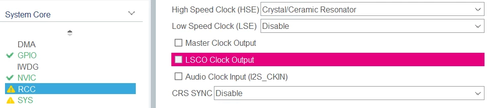

EliazLBAuthor
May 16, 2025
I just changed it and it worked perfectly !
