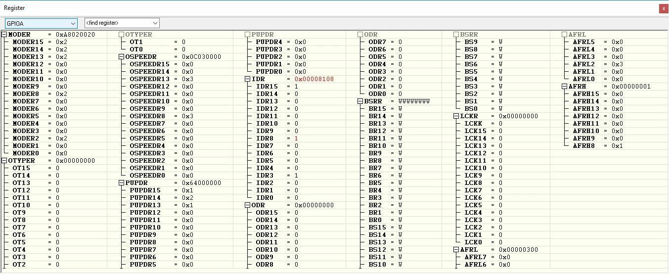

Here are posted screens about TIM9 and GPIOA.
In this particular project the same board generate also PWM signal, using another timer (TIM1). If I use two different board, the result is the same. PA2 is a pin linked to TIM9, used to acquire information from a PWM signal. PA8 is linked to TIM1 which generates PWM signal. It seems that the generation has success. Otherwise, IDR8 is costant, but it changes.
GPIOA

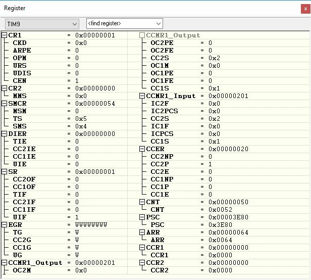

TIM9
I notice that CC2IE and CC1IE are at 0 value. I modify it manually but the result is the same.

Neither channel's capture is enabled in CCER.
