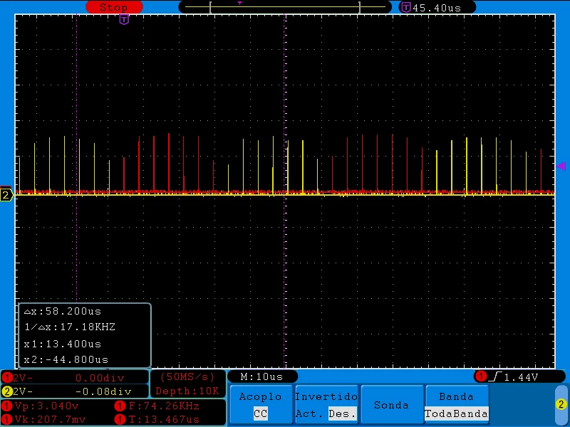

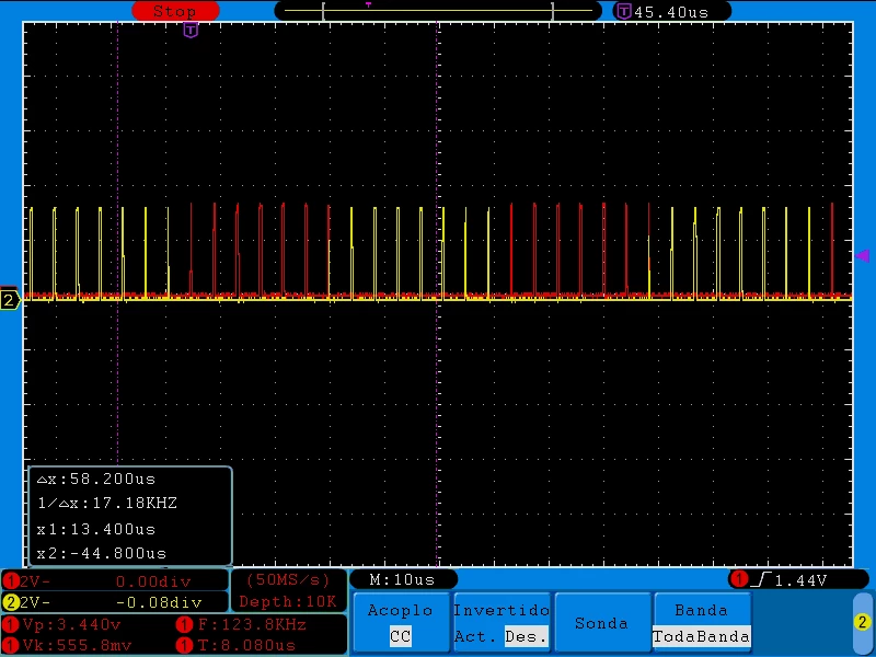

Hi, I'm using the PWM to create a sinusoid at a desired frequency and amplitude.
I have a table with the values, and I am updating it during the execution of the program. But I have an unexpected glitch that overlaps with the other modulation, and that would make me drive both transistors at the same time ... a total ruin in my application. Where does this glitch come from? I put some captures and my code:
Modulation without glitch:
After a while, the yellow glitch appears in the left:

u16 tim3A[14]={114,211,276,299,276,211,114,0,0,0,0,0,0,0};
u16 tim3B[14]={0,0,0,0,0,0,0,114,211,276,299,276,211,114};�?�?�?

void newtimereal(void){
u8 i;
for(i=0;i<4;i++){
timreal[i] = ((timmax[i] *modul256 *modfrec256)/256)/512;
//change frec different
void calculatetimereal(void){
newtimereal();
//CHARGE NEW FRAME *2
tim3A[0]=timreal[0];
tim3A[1]=timreal[1];
tim3A[2]=timreal[2];
tim3A[3]=timreal[3];
tim3A[4]=timreal[2];
tim3A[5]=timreal[1];
tim3A[6]=timreal[0];
//tim3B[6]=0;
tim3B[6]=timreal[0];
tim3B[7]=timreal[1];
tim3B[8]=timreal[2];
tim3B[9]=timreal[3];
tim3B[10]=timreal[2];
tim3B[11]=timreal[1];
tim3B[12]=timreal[0];
tim3B[13]=0;
//tim3B[6]=0;
Isn't this the overlap? Shouldn't tim3B values be shifted by one index? JW

Hello
Waclawek.Jan
Yes, I've been doing some tests, but putting it well, that glitch still appears.
The table has 7 nonzero values, however, I have 8 pulses.
Do you know why this glitch can be produced?
