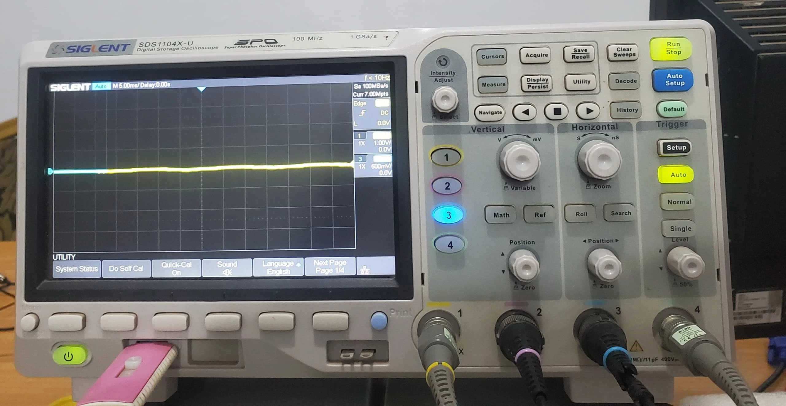

I tried generating PWM on my stm32g070rb but when I connected my PA7 and GND to my oscilloscope, the output I got does not look like a pwm signal in any way, I have verified my connections and now I think the error is from my code.WhatsApp Image 2024-07-27 at 01.19.34_3d2da966.jpg

    I don't see anything wrong with that code.
    Plain blinky (i.e. setting PA7 as GPIO Output, and then toggling it in a loop using a loop-delay) works?
    PS. You can post code using the </> icon at the top of editor.

    You should learn about, how to use/set a scope first.
    -> set probes to 10:1 and adjust them.

    Next bare metal musician. You know what RISC exactly mean?
    And debuger peripheral view ? And your code for better reading
