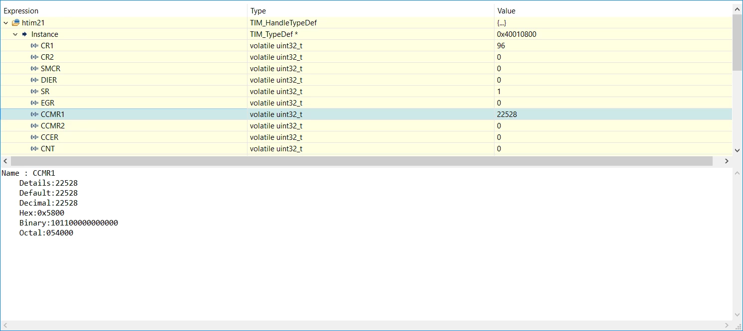

Hi All,
in my application, i need sometimes to stop PWM and Force Output to High.
I write this code but seem not run good.
void forcePwmActive(void)
   TIM_OC_InitTypeDef configOC;
   HAL_TIM_PWM_Stop(&htim21, TIM_CHANNEL_2);
   configOC.OCMode = TIM_OCMODE_FORCED_ACTIVE;
   configOC.Pulse = 0;
   configOC.OCPolarity = TIM_OCPOLARITY_HIGH;
   configOC.OCFastMode = TIM_OCFAST_DISABLE;
   if(HAL_TIM_OC_ConfigChannel(&htim21, &configOC, TIM_CHANNEL_2) != HAL_OK)
      _Error_Handler(__FILE__, __LINE__);
Can anyone help?

    What are the symptoms?
    What's the content of TIM21 registers?

    The effect is that if i measure with the oscilloscope the PWM output, is not forced to HIGH.

    What's the content of TIM21 registers (after the 'forcing' routine)?
    Read them out in debugger and post.

    Like you can see in the image below, the CCMR1 register have the bit [14:12] set to 101 like required
    in the datasheet.

    Yes indeed, but also CCER is all zero which means the CCxE bits are cleared.
    Try to set them.
