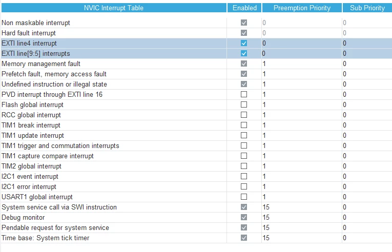

Hello guys,
I am currently creating a drone using a BluePill STM32F103 and IDECube. I need to read PWM signals from a receiver (FS-IA10B) that provides me a 50Hz signal with a duty cycle between 5% and 10% (I am using a flysky transmiter)
I don't have enough timers on the BluePill (only x4) to read PWM with the function 'Combined Channels' and, at the same time, generate PWM using the function 'PWM Generation.' So, I came up with the idea to use EXTI pins to measure the high state of my 4x pins. The results I got are really precise, but the problem I am currently facing is that I randomly get some 'spikes' on some of the 4x pins.
For information, I am using Timer1 with a prescaler of (72 - 1) and counting to 65535 in order to have a resolution of 1us. I manage the buffer overflow of Timer1 as well in my callback.
The spikes looks like that (Thrust channel in blue):
spikes.pngThe spikes are really high at the beginning, and they start to slow down and eventually disappear for some time, before coming back again.
My interrupt code looks like that:

I believe that some other higher-priority interrupt occurs at the same time, causing my timer to keep running during the other interrupt. However, even after setting my callback to the highest priority and all other interrupts to a lower priority (just for the test), I still encounter the same problem.
Do you guys have any ideas where the problem might be?
Thank you in advance for your help.
Sorry for my English; it is not my native language.

Can you increase the priority of the interrupt? Or better decrease the priority of other interrupts until you find out which one is triggering? If you can't use a proper input capture peripheral then your only alternative is to ensure this has the highest priority if you don't want the measurement disturbed.
GroundSkyAuthor
Jan 29, 2025 12:30 AM UTC
I increased the priority of my 2 EXTI channels and decreased the others, and I still have the same problem.
