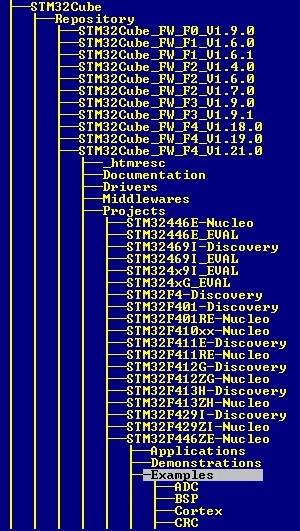

    The HAL is provided with complete source code, and the code trees contain dozens of examples and demo applications, for dozens of boards.
    Use a file manager, or static analysis tool of your own preference to navigates the available resources, find examples that closely match your goals and port to the target platform.
