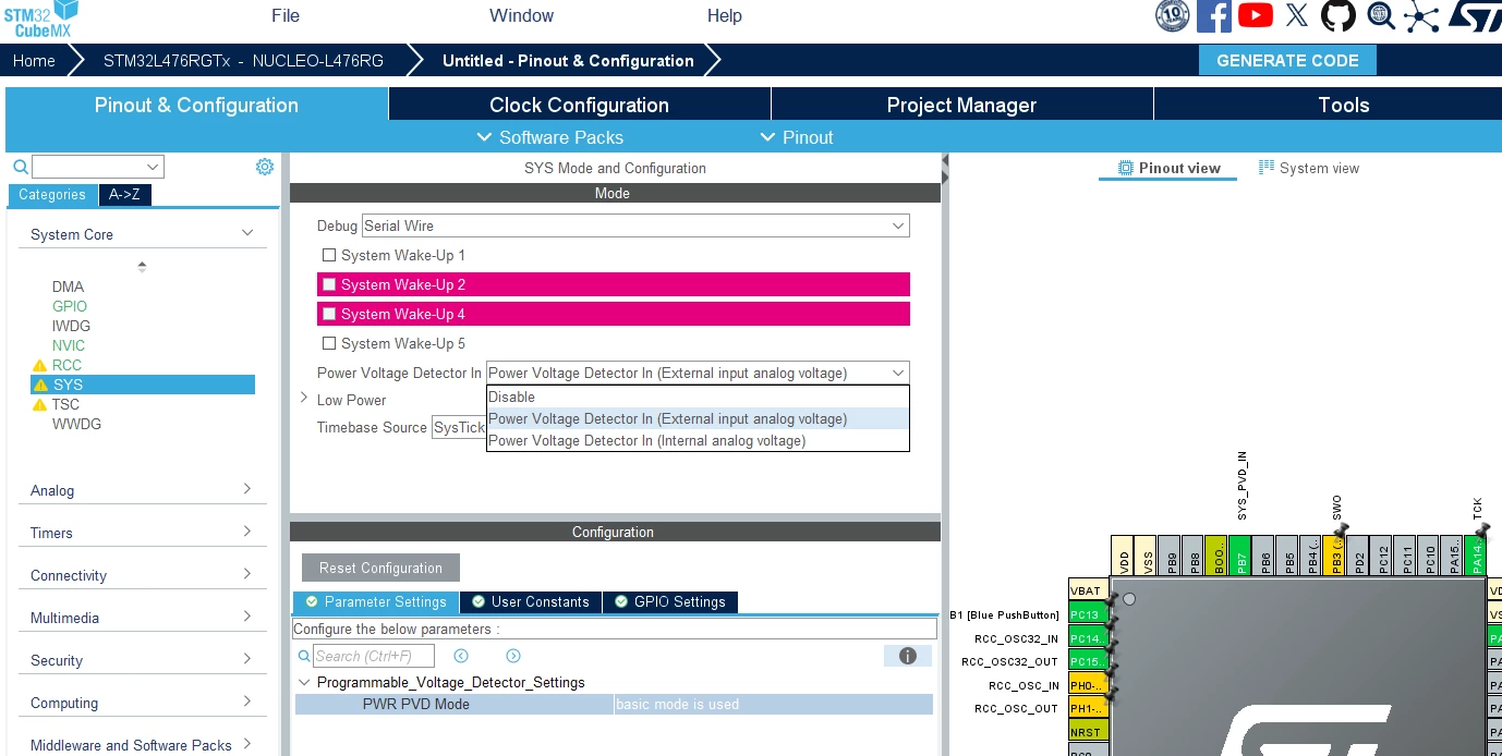

As an example on STM32L476 device (Nucleo-L476RG)
According to DS10198 Rev 11 in Table 16. PVD_IN is an additional function connected to PB7.
And in RM0351 Rev10, PVD can be configured in PWR_CR2 bits PLS[2:0] = 111.
In STM32CubeMX here the possible PVD levels configurations:
The internal voltage reference VREFINT is calibrated in production with VDDA=VREF=3.0V at 30°C, is around 1.2V (see DS10198 Table 26) and it is enabled when VDDA and VSSA are supplied.

From MX Cube I see, that PB7 is configured as analog with no pullup/down.
This was also my intention but i didn't find it in the docs.

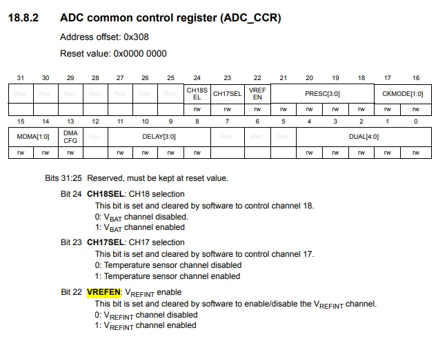

Where did you get the information, that VRefint is available when VDDA and VSSA are supplied?
For ADC conversion of VRefInt VREFEN of ADCx_CCR must be enabled.
Can PVD use VRefInt Independent of ADC and VREFEN?

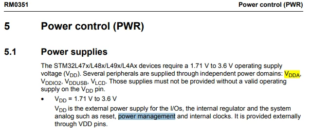

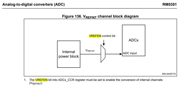

RomainR.
January 13, 2025
Hi @CanRF
Sorry, I made a mistake and I misled you. I mixed up the VREFINT bandgap with the VREFBUF.
I'm referring to RM0351 in section 5 Power control (PWR)
  • VREFINT is powered by VDD (not VDDA) and is related to Power management (PMU)
  • The VREFEN control bit is specific to ADC input for internal conversion.
When PLS[2:0] = 0b111 in PWR_CR2 register. The external input analog voltage PVD_IN is compared internally to VREFINT. It's independent from ADC.
Best regards,
