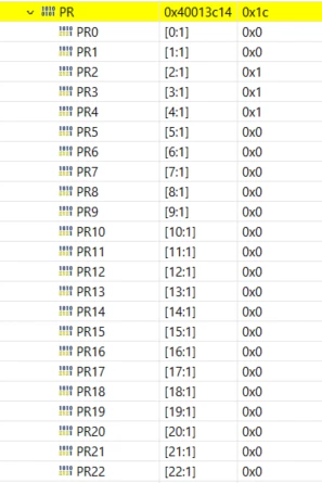

Pushbutton causing multiple ISR flags (EXT-> PR) to set??
So I have three switches (nothing special just momentary push button) wired into the board PC2, PC3 and PA4. All are using internal pullups. PC2 and PC3 are set for rising / falling trigger IRQs and PA4 is set for falling IRQ. They all have their own ISR function and use a single callback. I am monitoring EXT -> PR register (interrupt flag) and I notice that when I push one of the buttons it will sometimes set 1, 2 or even all 3 of the flags and I never touch the other buttons. Here is an example of me pushing PC2 and 2,3,4 all went off. Sometimes only the one I want goes off as I would expect but many times multiple flags get set. There is nothing else on top of the board. It is a Nucleo-F401RE. Any ideas as to what could be going on here as I am totally confused?

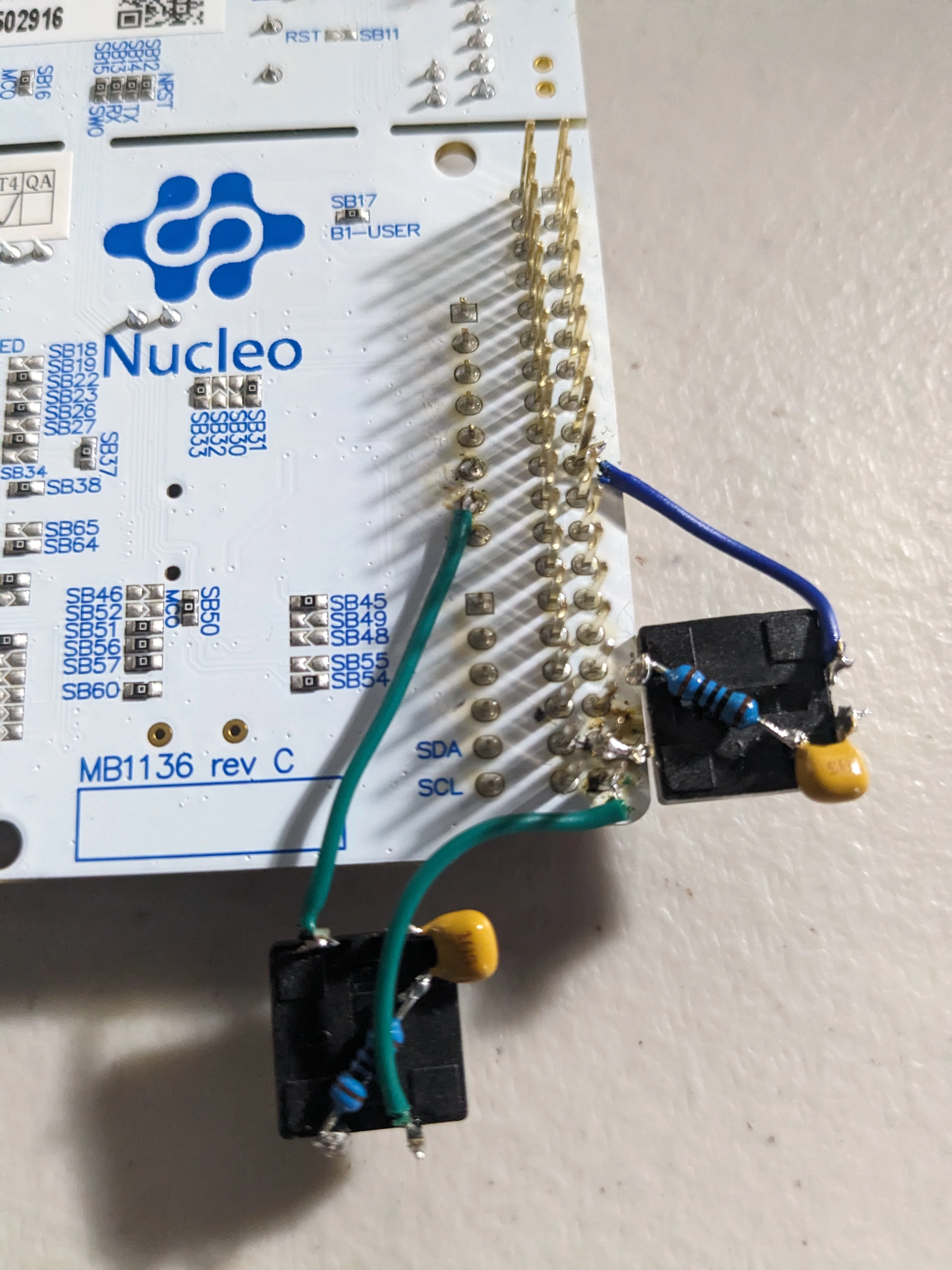

I seemed to have solved the issue.....Not completely sure but so far no false triggers have appeared. I mimicked the blue button on the nucleo board with respect to adding 100 ohm resistor between 0.1uF cap and ground.

Maybe EM (capacitive) coupling between the pins, especially if the related wires/tracks are run next to each other.
The EXTI is asynchronous and it can react to pulses shorter than the system clock period.

Good thought but no....I wired 0.1uF capacitors across both switches and shortened wiring.....This should be ridiculously simple, not sure what is going on....Low level code that clears PR suggests to set register using = instead of |= ....I set breakpoints with the handlers .... _it.c file on each switch and after pushing one switch check the PR flags to find both flags getting set???

 Callback itself (main.c) ...Pushing either swCompress or swExpand switch most times causes multiple flags to go off (PC2 and PC3).  I disable the IRQ in the callback and wait for a timer to go off 100ms later (debounce) and within the timer I read the GPIO level
