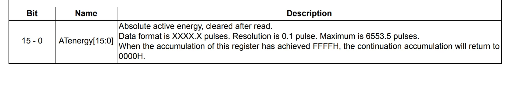

I am working with STM32G491RE.I communicating  ATM90E26 single phase energy meter with STM32 through SPI communication.
I can able to read voltage ,current values correctly from the meter.
For KWH calculation, I am reading Absolute active energy register for kwh values. In the datasheet they mentioned the values I receive from the energy register are pulses.
  how can I convert pulses to kwh. can anyone suggest?
my pulse constant value is 1000 imp/kwh.
From the datasheet they mentioned register will be cleared after read.
That's just basic arithmetic, surely?
"imp/kWh" is, presumably, short for "impulses per kWh" - in other words, "pulses per kWh"
So "1000 imp/kWh" means that you get 1000 pulses for each kWh
So 1 pulse is 1/1000 kWh - ie, 1 Wh
So that's telling you that the number in the register is in units of 0.1 pulse;
eg, if the register value is 65535, that represent 65535 * 0.1 pulses = 6553.5 pulses.
As we've already established, 1 pulse represents 1 kWh - so 6553.5 pulses represent 6553.5 kWh.

Well, these are all questions that have little to do with an STM32 as already mentioned before. Only the reading of the ATenergy register, which you read with 8-bit accesses, should be done with a 16-bit access.
The manufacturer of this component or its forum can (perhaps) help you with the other questions, as already mentioned too.
