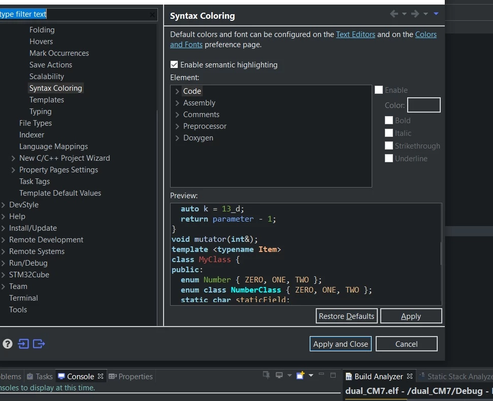

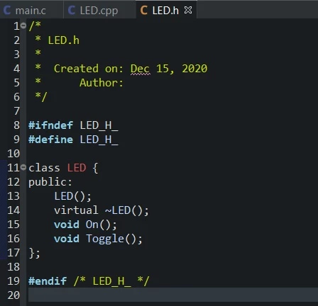

Hello, why are the keywords class, public, virtual not in bold font?

    It will be bold if you install DevStyle from the Eclipse Marketplace.
    Please make sure http://download.eclipse.org/releases/oxygen/ is part of the Available Software Sites for it work:
    Window > Preferences > Install/Update > Available Software Sites
    Good luck!

    But as Eclipse-based IDE, you will find thess settings under Windows->Preferences.
    And there, under C/C++->Editor->Syntax Coloring.

    Classes are in the blue category, why dont I see blue?
    yawn..O well.

    ahaha I installed the dark theme but unclicked the Devstyle.
