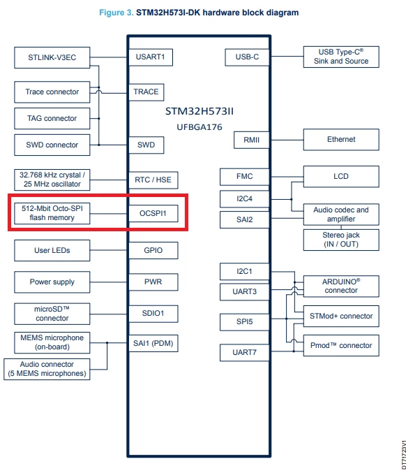

Dear Team,
Currently, we have developed a prototype with an ESP32 and the prototype meets all the functionalities. However, we are now having some troubles scaling it to production. So now we are looking to migrate our product to using STM MCU. We have found STM32H573I-DK closely matching to all the peripherals we require for our product.
Basically, we need WiFi, 1x Ethernet, 1x SPI, 1x I2S (for Microphone input, can be analog too with external codec), 1x I2C and a handful of GPIOs. We would also like to have 16MB flash memory and 2MB of RAM for backward compatibility with the ESP32, but STM Discovery Kits dont seem to support such high flash & RAMs. An FPU would be also nice to have feature.
Looking forward to your suggestions.

mƎALLEm
July 8, 2024
Just to mention that There is an 512-Mbit Octo-SPI flash memory on the board:
But unfortunately no high SRAM size on the board.
