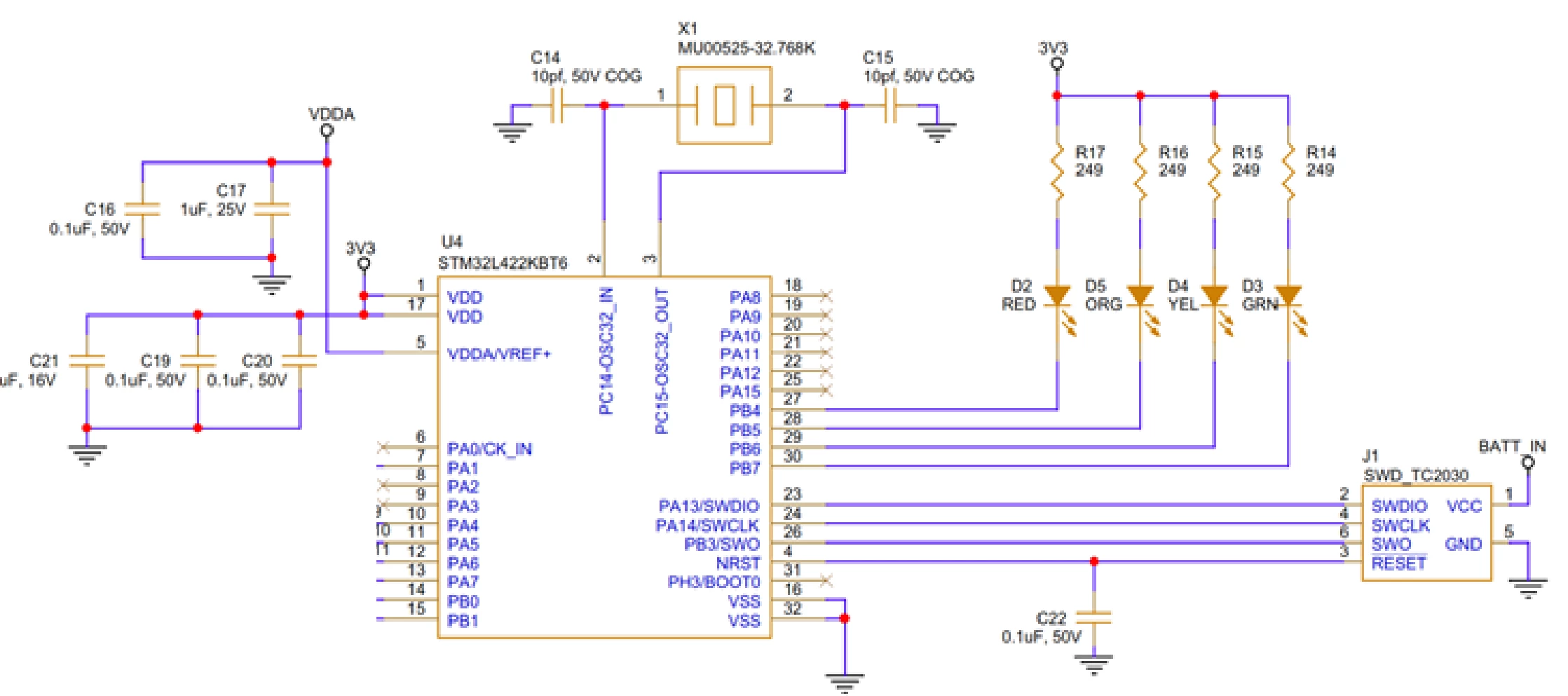

I have created the below circuit and build a PCBA. I'm using the J-Link Base Compact and Tag-Connect TC2030.
Using the Arduino IDE I created a simple sketch to drive the 4 LEDs shown on the schematic below and blink every second.
The code compiles ok and Arduino IDE reports that it has successfully upload to the SMT32 chip, but the LEDs won't blink. I tried enableling outputs to other pins as well, but the problem persists. Any ideas what might be causing this? I'm using the Generic STM32L4 series "board" from Arduino library.

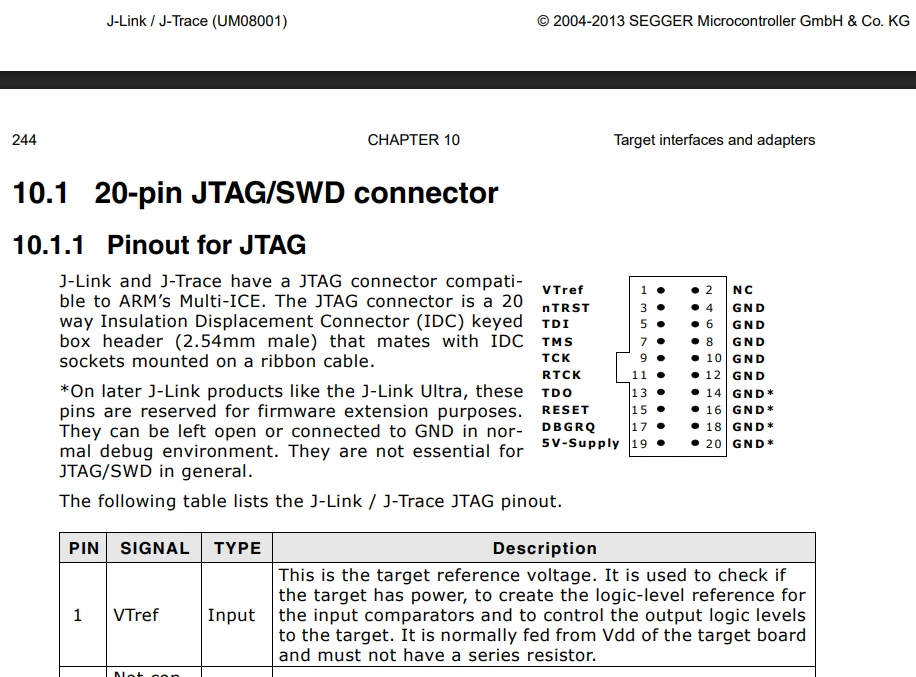

So your J-Link should connect to 3V3 - not BATT_IN.
It's for the J-Link to sense what voltage the MCU is actually running at.
PS:
Not the latest manual, but:

Tied Vref to 3V3 and I can now toggle a pin. Not sure if that did it since the VTref is only to detect power presence? Isn't it only looking for a voltage?

Not just presence; it also sets the voltage levels of the J-Link interface - this is what lets it work from 1V2 all the way up to 5V.
So, if it's looking at the wrong voltage, then the whole J-Link operation becomes suspect.

Where is VDDA supplied from ?
What is BATT_IN? Are you using the J-Link to supply power to the board?

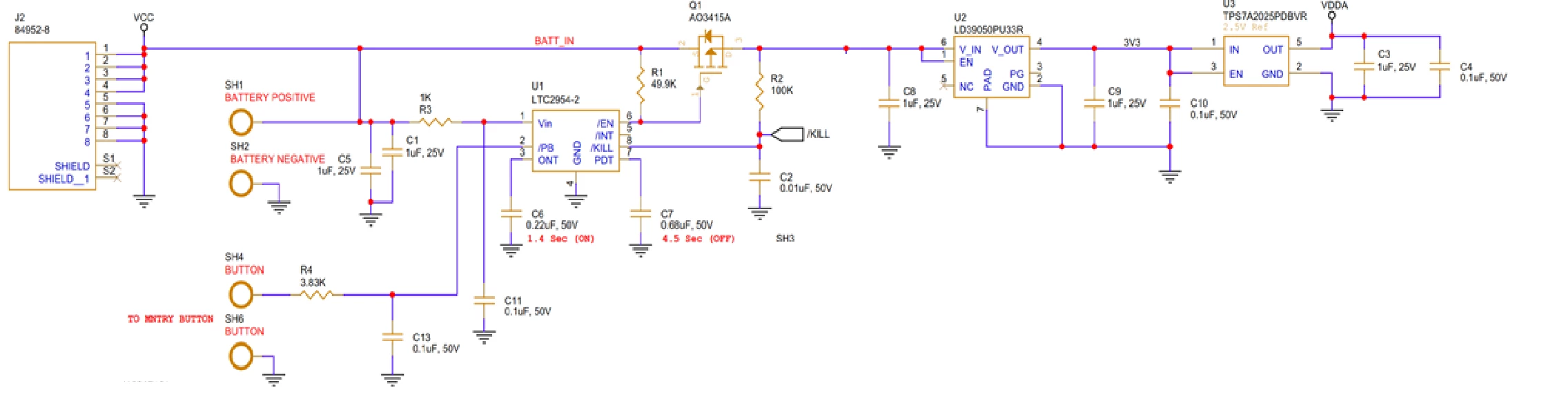

VDDA is tied to 3V3 and BATT_IN is voltage before the regulator, which is about 3.6V.
And yes, the code was tested on the nucleo without issues. This is the rest of the circuit. U3 is not installed and VDDA is tied to 3V3.

So you are using the J-Link to supply power ?
I think you should check with Segger whether this is a valid configuration: I think it's intended to supply power direct to the target MCU - not via a regulator?

No, BATT_IN is connected to an external power supply.
