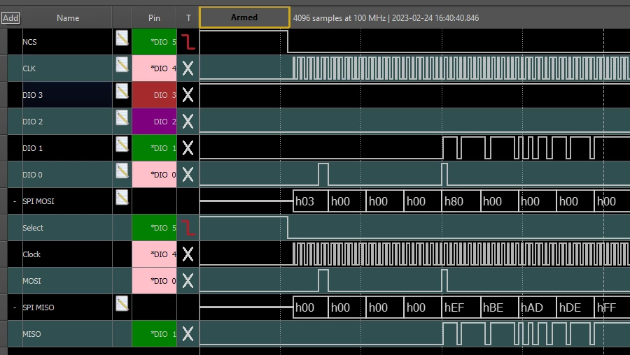

Even more confusing, the signals coming back from the memory mapped operation look completely fine:
0693W00000aHdsAQAS.pngAm I missing something obvious? Do I need to explicitly disable cache? I'm just really lost here.

The Dummy Cycles DCYC=4 is causing the shift in the Memory Mapped data, READ (0x03) has no dummy cycles
