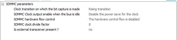

For the configuration of the SDMMC1 interface i setted the Clock at 50MHz on the Clock Configuration, and a Divide Factor of 8 (tried 0, 5 and 6 but have the same result) :
Could someone help me solve this issue?

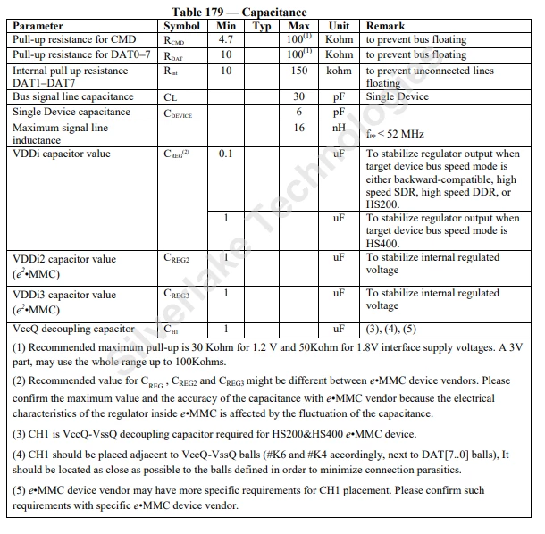

- why do you have 5pF caps there?
- why do you have everywhere pull-ups? (really needed?)
- are you sure to have an external eMMC chip for 3V3 logic levels?
  (there are different versions, for different "interface power")

As per JEDEC standard, i applied what I learned from the standard no.JESD84-B50 :
So yes, pull-ups are indeed needed, and capacitors also.

I'm having an issue that appears to be identical, except with an STM32N657. I'm getting stuck in this same loop, and like you also seeing that my eMMC is responding sensibly to the commands prior to trying to retrieve the extended CSD.
yaxsomoAuthor
Jan 19, 2025 6:38 PM UTC
Anyone who can help me figure out the issue ?
