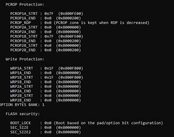

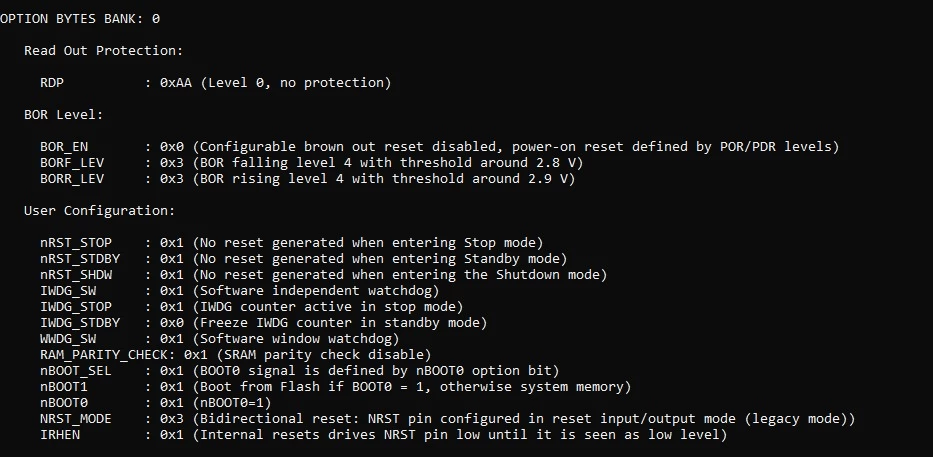

Question Had you enable the "Hardware watchdog" feature through the device option bits?  Because you share the WWDG_SW (for Window watchdog) and not the IWDG_SW (for Independant watchdog). According to the Reference Manual, " The watchdog is automatically enabled at power-on, and generates a reset unless the IWDG key register (IWDG_KR) is written by the software before the counter reaches end of count or if the downcounter is reloaded inside the window.". Also, how did you set nRST_STDBY bit ?
Independent watchdog is enabled in the firmware flashed in the process mentioned above. With option bytes, we had only modified the IWDG_STDBY bit to 0.  Rest of the option byte configurations are kept as it is.
Attaching the screenshot of the complete output of option bytes read command.
nRST_STDBY is not changed by us and is still the default value of 0x1.
If you have noticed anything wrong with the way I configured the option bytes, please let us know.

  • I don't think your issue is coming from IWDG. But if you want to be sure the IWDG is not an issue. You can disable the clock to the counter of IWDG when the core is halted ? Before entering in shutdown mode, you can do this by setting the bit n°12 DBG_IWDG_STOP in the DBG_APB_FZ1 register. (Also, it's not my advise because this is not the issue)
  • Also, you configured BOOT_LOCK bit to 0 and nBOOT_SEL, nBOOT0 & nBOOT1 to 1. According to table 8. Boot modes in RM044, your boot area is the Main Flash memory. The Main Flash memory is aliased in the boot memory space (0x0000 0000), but still accessible from its original memory space (0x08000000). In other words, the Flash memory contents can be accessed starting from address 0x00000000 or 0x08000000. Or your register PC = 0x1FFF19A4, that's the system memory at this address. You wan to run your code from flash (in the first PC you gave PC = 0x08003A00) What is at this address ? and when were this registers captured ? It can explained why the firmware isn't executed.
  • That brings this third point : How did you upgrade your firmware ? USART, I2C ? Have you consider AN2606 and AN3155? Here is an extract : "When an application is loaded into RAM and then a jump is made to it, the program must be configured to run with an offset to avoid overlapping with the first area used by the bootloader firmware (refer to STM32 product datasheets and to AN2606 for more details about the RAM offset for the used device).".
