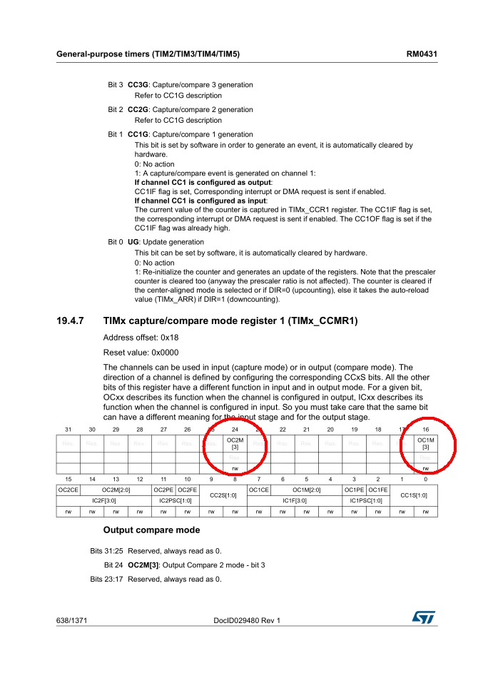

According to what I learned from the course and what I found in the reference manual, https://www.st.com/content/ccc/resource/technical/document/reference_manual/group0/c8/6b/6e/ce/dd/f7/4b/97/DM00305990/files/DM00305990.pdf/jcr:content/translations/en.DM00305990.pdf , this should work.
However, I noticed something remarkable in the manual. In chapter '19.4.7 TIMx capture/compare mode register 1 (TIMx_CCMR1)(x = 2 to 5)', 'Bits 6:4 OC1M: Output compare 1 mode.'
OC1M is a three bit field in the register diagram, however the options provided in this chapter for setting up this register all consist out of four bits. This doesn't make sense to me. Anyways, following the instructions from chapter '19.3.8 Output compare mode' I set OC1M to '011' to toggle on match.
If I understood everything right, this should set the output on PD12 to high when it's low and to low when it's high, when the value in CNT matches the value in CR1. This should be the signal that goes trough the jumper wire and should get captured by TIM5 that I assume to be running in input capture mode.

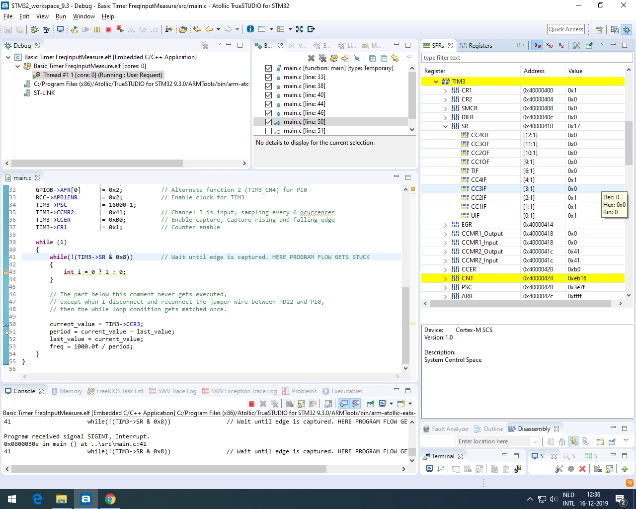

Nevertheless, the result remains the same despite using different timers and pins. Also, according to the user manual, the gpio uses multiplexers on the different pins so the functions of the pins can be selected using the alternate function modes. Following what's written in the reference manual and the user manual, this means that my initial program should still be right. I'm using Reference Manual RM0431 and Datasheet https://static6.arrow.com/aropdfconversion/29737e50fc5e53cf3b25bd139bc2d144ac0a47a/179979946274536379.pdf
after searching for "STM32F722xx STM32F723xx" in google, st.com comes shows another datasheet belonging to another device, despite what the link in the search result says.
Anyways, when I connect PA15 and PB0 with the jumper wire, the same issue occurs.
I'll ad a screenshot of the debugger with TIM3 registers open. The only value that keeps changing while the program runs is CNT.

waclawek.jan
December 16, 2019
Does the respective GPIOB_IDR bit change?
Zeron
ZeronAuthor
December 16, 2019
Nothing changes in GPIOB_IDR. The port is in alternate function mode, so nothing will change in here also.
waclawek.jan
December 16, 2019
IDR always reflects the input pin's state, except when it is set to Analog - i.e. also in Alternafe Function mode.
If you can't see change there, it means, the input does not change (or changes too rapidly). Use an oscilloscope/LA to observe the pin; try to connect it to high/low directly (or, maybe better, through some current limiting resistor).
Zeron
ZeronAuthor
December 17, 2019
Indeed, I checked IDR in the debugger and its toggling on and off. I took a whole bunch of screenshots of all different debug steps to eventually come to discover that my final version of this program happens to be working afterall.
I think I should have taken a break a bit earlier. Maybe I didn't put the jumperwire in the connectors the right way, It barely fits. Or some other fysical earthly circumstance that skipped my notice.
Anyways, its working now. Thank you for your effort, I can continue to the next chapter of my course.

Oh no, it wasn't working. My final change of yesterday, the one that I didn't test yet made the difference.
TIM3->CCER |= 0xB0;
should be
TIM3->CCER |= 0xB00;
Good, I can close chapter timers now and proceed with interrupt service routines.
