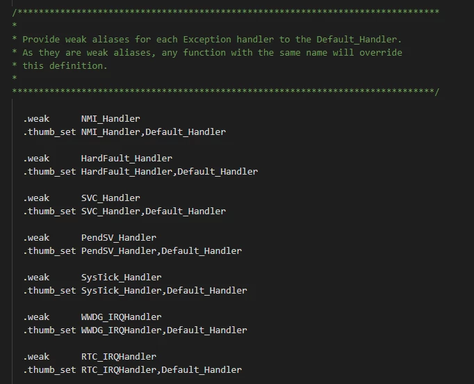

Program does not get into hard fault exception when expected to do so
If I understood correctly the a hard fault exception handler should catch all exceptions that do not have a specific handler that should execute when they are thrown. For example: if I enable button interrupts(say falling edge) and configure EXTI0 properly then I press the button(PA0) the cpu should try to find this ISR EXTI0_IRQHandler(). That works fine. But say I don't have that implemented. Shouldn't we end up in 'HardFault_Handler' then?
I'm using a STM32F446 controller from an STM32 nucleo board.
I wrote this code and tested if the code gets to 'EXTI0_IRQHandler' when I press the button. That works fine. I then commented out this ISR and expected the code to reach the hard fault handler isr when pressing the button. However that does not happen. The code stays stuck in the while loop. Please help me understand why that is happening and please correct me if I understood hard fault handlers in a wrong way. Thanks! This is the code:

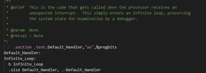

all handlers are defined as weak functions which default to an endless loop. If you do not override the handler this will default to it. This is usually in the toolchain specific assembler startup code.
These snippets for example come from the startup_stm32f030x6.s file for gcc created with CubeMX.

But I did overwrite the handler(please see my code line 133-143). The name of the function I overwritten is 'HardFault_Handler'. The code still doesn't go there. It stays in the main program loop even if the interrupt request was triggered.
Also about your remark about the infinite loop. The dummy handlers are indeed infinite loops. But if the hard fault exception triggers shouldn't the code go to there(in the startup code to the dummy handler)?

In lines 133-143 you overwrote the HardFault_Handler, not the EXTI0_IRQHandler (as stated, you commented it out).
Your assumption "If I understood correctly the a hard fault exception handler should catch all exceptions that do not have a specific handler" is not correct. If you do not implement a given handler, you will end up in the default handler of that given exception which happens to be a tight loop.
