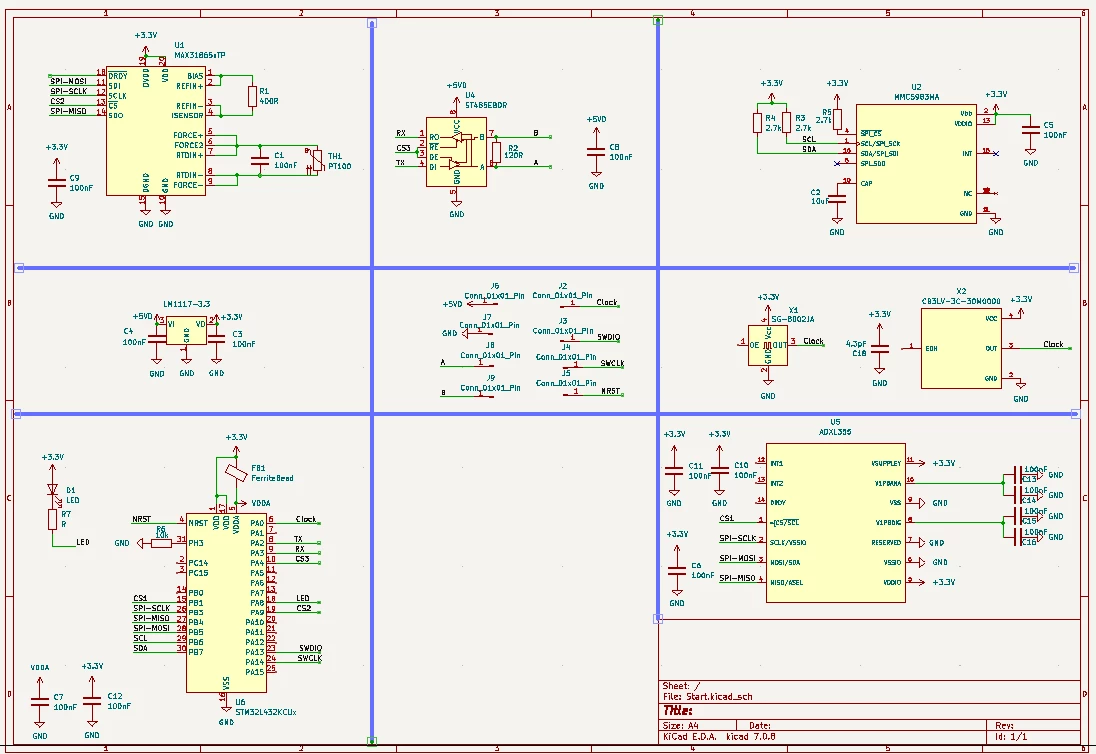

Visitor II
December 10, 2023
Hi, I have the same problem as you, I designed a board using STM32L432KC according to the Nucleo-32 board.
But I succeeded in programming the chip in my board just once, for the second time it had an error "No Target Found".
I see you overcome this problem, can you tell me what to do? What is LDO and SMPS you are talking about?
is it a kind of regulator? and what should I do to solve the problem? I am using a LM1117-3.3v regulator that is a kind of LDO. So what is wrong with my board? I uploaded my schematic as well.
