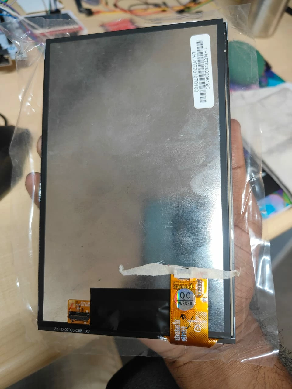

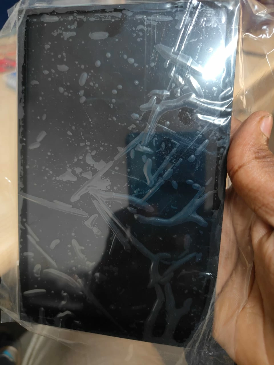

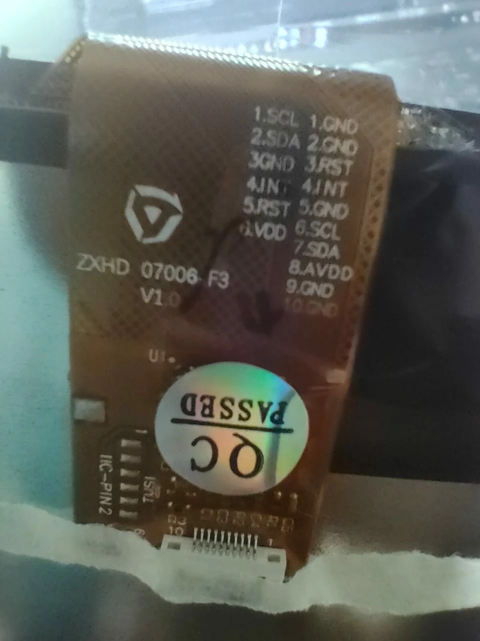

thank you for recommended product, before using for medical purpose,for testing purpose , here we decided togo for simpler mcu like stm32f405xx or stm32f407xx ..IS stm32F4 discovery board can be sufficient for using 1080pHD display for ECG wave from ads1298 module where print the waveform in thermal printer(8inch) from display(7 or 10inch).
if this is capable of doing , then please give link for display product suits the board and any interface display to board driver module and necessary drivers.
also,i already have a mipi android display, is that can be used for us.?
i attached necessary files below.
please.help me for clearly go for purcase of  stm product confidently.

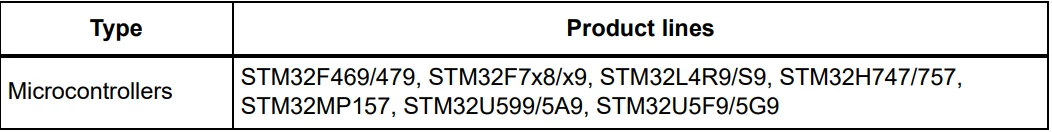

Refer to this AN.
stm32F407 MCU doesn't feature MIPI-DSI.
This is the list of devices featuring MIPI-DSI host peripheral:

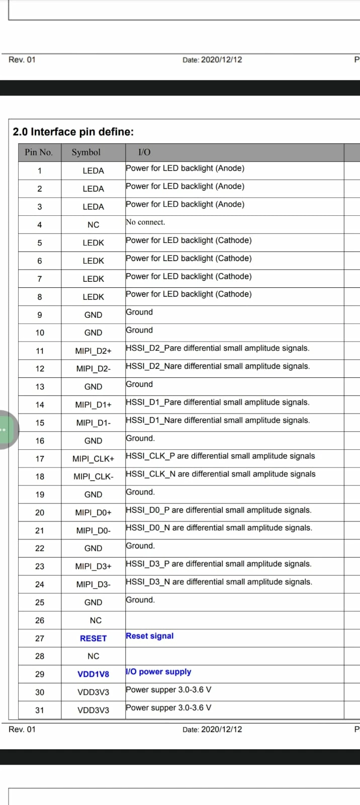

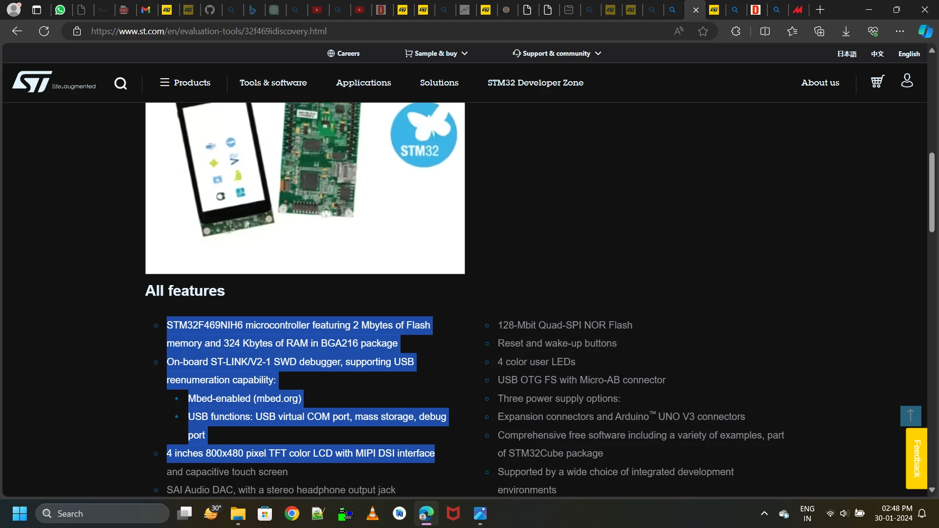

is this board used for the display i have,?
mƎALLEm
mƎALLEmBest answer
January 30, 2024
I'm not an expert of MIPI-DSI interface but STM32 MCUs support maximum two lanes (differential D0 and D1 data) but your LCD has 4 lanes (differential D0, D1, D2 and D3 data bus). So check your LCD spec if it has a configuration that could work with two lanes.

Hi, how are you? Thank you for your support with the STM32. After discussing with our seniors, they advised us to develop the patient monitoring system in the quickest and easiest way possible. The first step is to display the ECG waveform from the ADS1298 module, using a suitable board.
This board should  Primarily, it needs to be compatible with a TFT display of around 1080x800 resolution. We are considering the STM32F769NI-DISCO board, but have some doubts about it:
  1. Is this board capable of supporting an external high-definition display with 1080x800 resolution via MIPI or a 24-bit parallel interface?
  2. Do we need any additional components for using the GPIOs and other peripherals?
  3. Is the board's RAM sufficient for managing an external display and other components that may be added in the future?"
