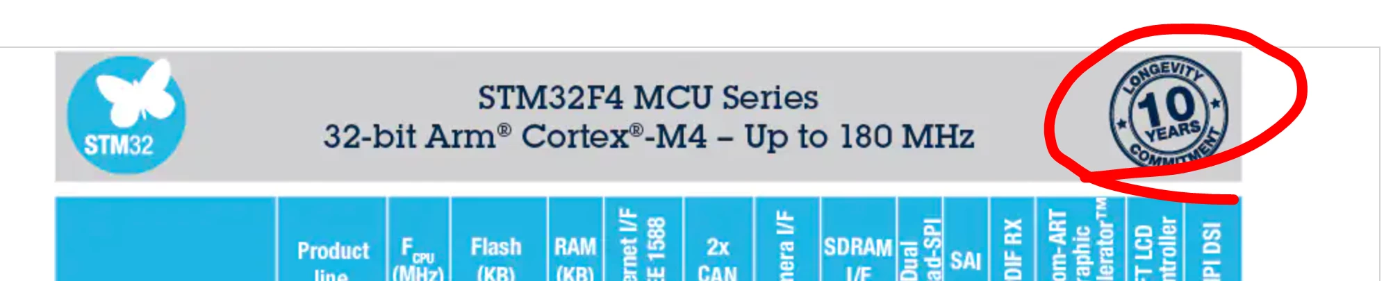

We are looking for Controllers for our us based client. I want to know Product life and active years from this family of STM32(STM32F0 Series, STM32F4 Series, STM32F7 Series).  Can Someone help to find where i will get this info.
it should be greater than 10 Years.
Thanks,
Gm
TDKBest answer
October 30, 2023
On each family page you can see the 10 year commitment.
In practice, this 10 year date keeps getting pushed out indefinitely for these chips.

There's a page dealing with product longevity and the date the clock stopped ticking.
https://www.st.com/content/st_com/en/about/quality-and-reliability/product-longevity.html
These guarantees are only as good as the motivation and production facilities and resources to sustain them economically. If you want to ensure actual availability you should stock-pile and hedge yourself.
