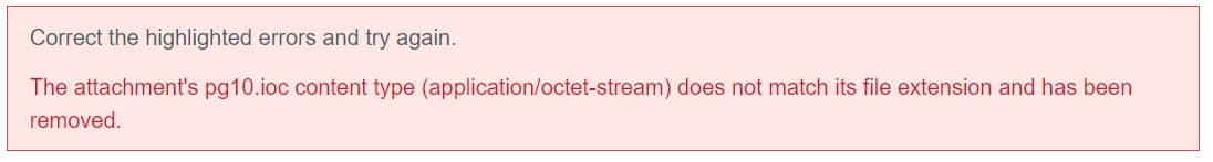

GeertZelfAuthor
November 16, 2023
Hi David,
Thank you for your reply. I'd love to send my .ioc file. But the site refuses to accept it.
Has anyone a solution?
