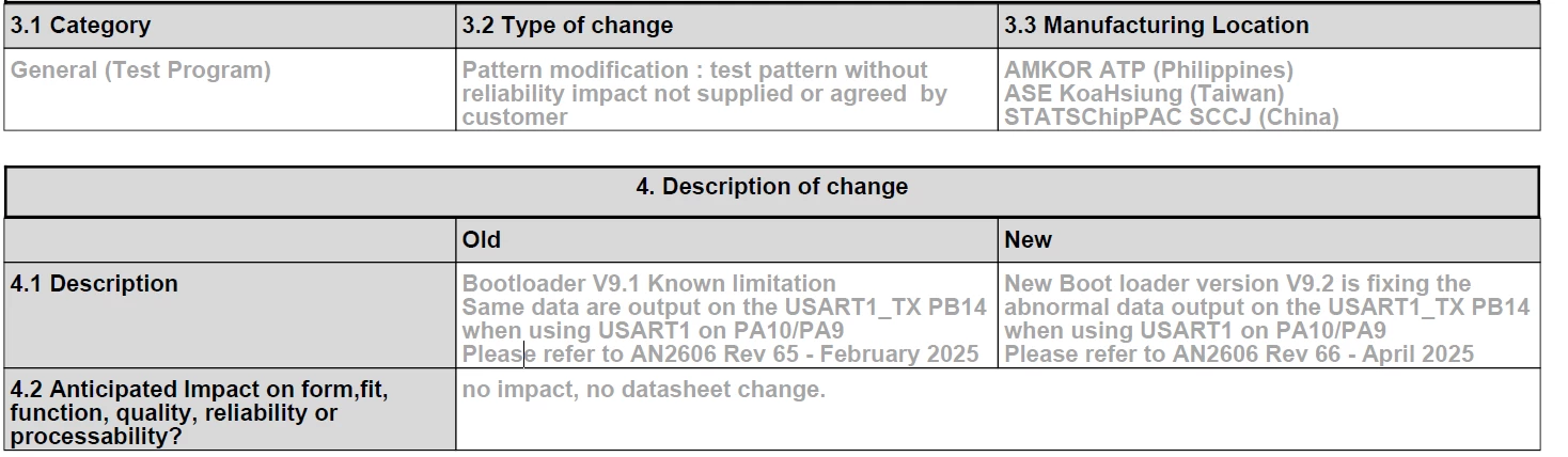

We are using STM32H743 Controller in one of our LRU (Line replaceable unit).
Since February end, The LRU System Test equipment cannot load the programming (.bin ) file to many units. This is the first time this specific failure mode has appeared. This is also the first time that any kind of OPS programming failure has appeared that isn't an operator or facility issue.
We have tried loading the  .bin file using STM32Cube programmer as well but still the issue exists.
We have recently come across this PCN where Bootloader version of 9.1 is Changed to V9.2 resolving abnormal data output on the USART1_TX PB14.
  1. We are using USART3_TX on PB14 and USART3_RX on PB11.  Do you think OPC bootloader V9.1 to V9.2 has any impact on USART 3 interface used for RS-232 ?
Note , once we replace the STM32 IC with the old batch code , this issue is resolved.

First recommendation I share is to check the bootloader version for both batch of devices.
Depending on the bootloader version, you may confirm or discard some assumptions.
Your reference is AN2606: depending on the version, please check the table "Table 124. STM32H74xxx/75xxx bootloader version" for the known limitations (mainly what is related to USART1 pins in your case).
Please keep me informed about the outcomes of your checks.
