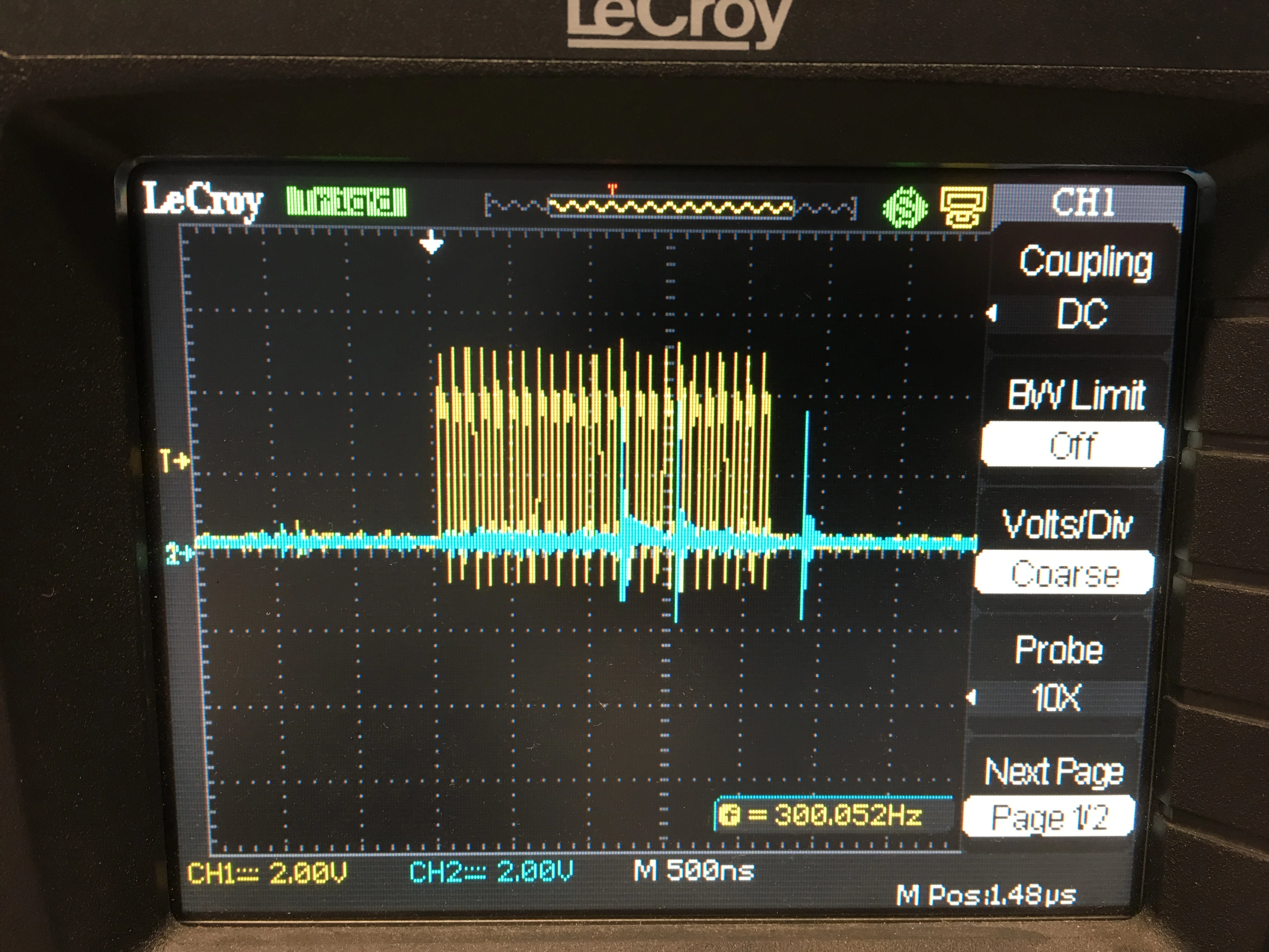

I have a Nucleo-F446RE Eval Board with a STM32F446 RET6U. I use the SPI2 peripheral. When I switched from baudrate prescaler 4 to 2 I get problems with the SPI status flag 'Rx buffer not empty': The last flag does not trigger at certain conditions. When a additional delay is generated in the write/read process of a SPI Byte, the flag triggers. Is it possible, that the 'Tx buffer empty' and 'Rx buffer not empty' flags can cause an access conflict at the flag register?
I added pictures to describe the situation more clearly:
The yellow line corresponds to the SPI CLK. The blue line corresponds to a 'Rx buffer not empty' flag trigger action.
Picture 1:
Baudrate prescaler 4 is used. Bytes are written after 'Tx buffer empty' flag triggers. All three 'Rx buffer not empty' flags trigger.

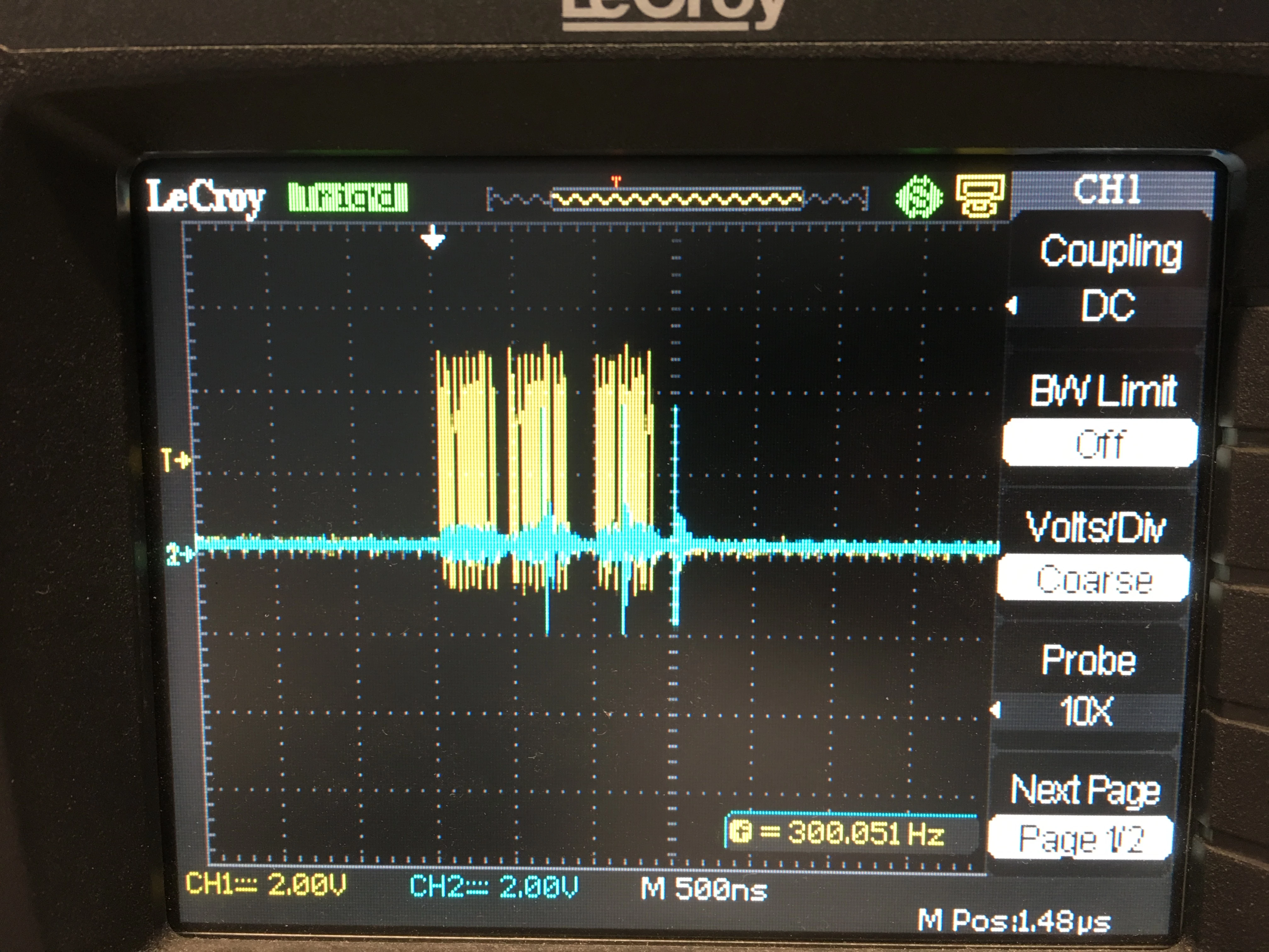

Picture 2:
Baudrate prescaler 2 is used. Bytes are written after 'Rx buffer not empty' flag triggers and data register has been read out. All three 'Rx buffer not empty' flags trigger.

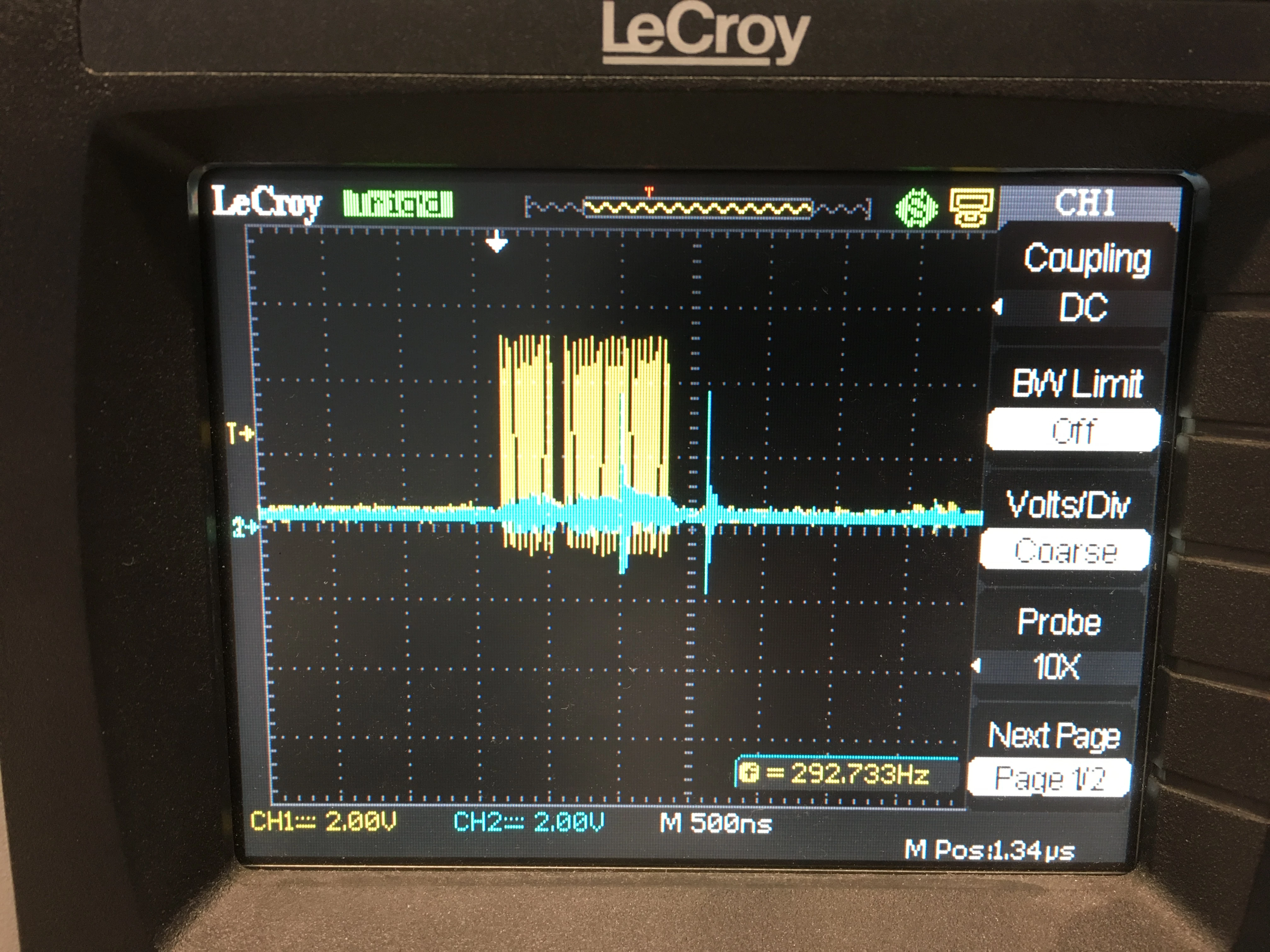

Picture 3:
Baudrate prescaler 2 is used. Bytes are written after 'Tx buffer empty' flag triggers. Only the first and second 'Rx buffer not empty' flags trigger.

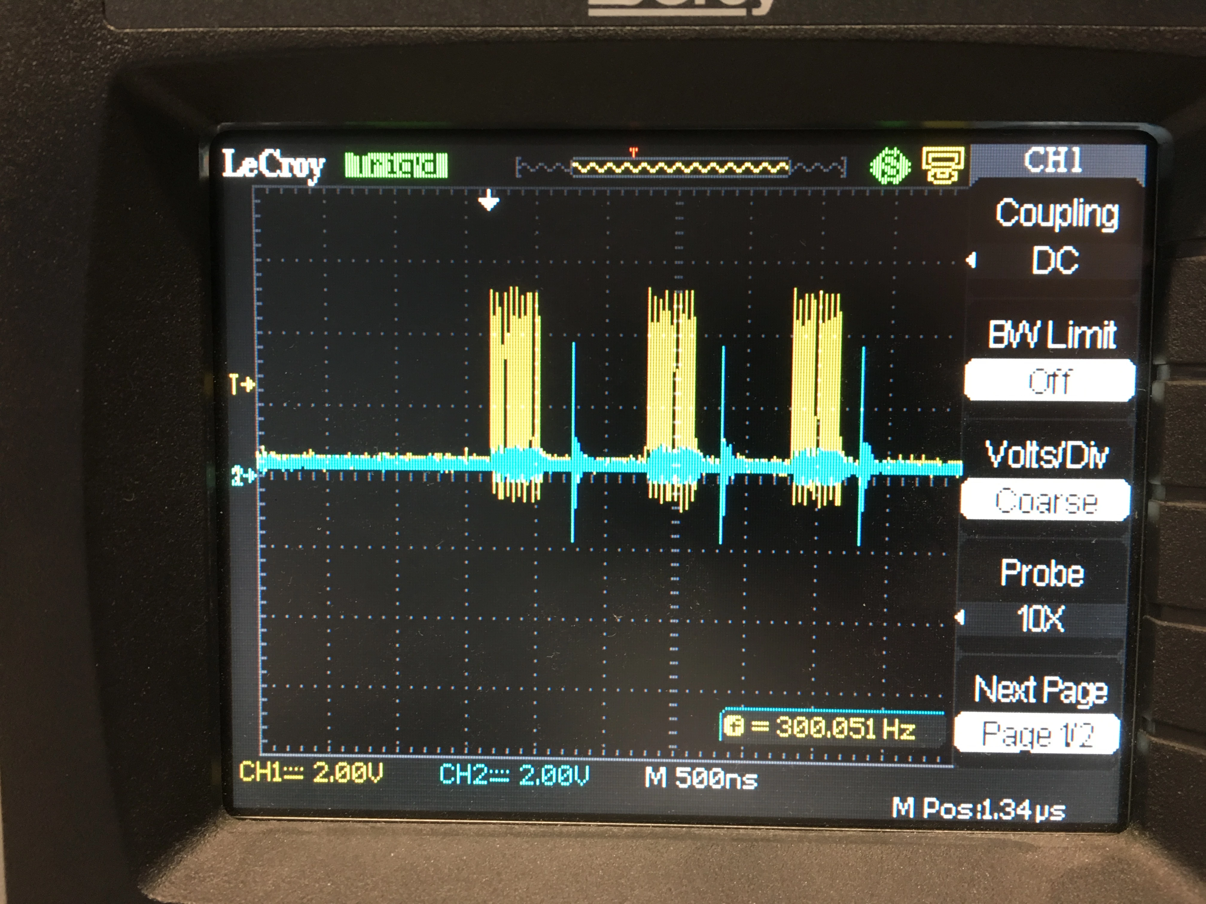

Picture 4:
Baudrate prescaler 2 is used. Bytes are written after 'Tx buffer empty' flag triggers. Now additional delays have been added. All three 'Rx buffer not empty' flags trigger.

    waclawek.jan
    January 4, 2017
    Posted on January 04, 2017 at 13:35
    How?
    Andreas Fischer
    January 4, 2017
    Posted on January 04, 2017 at 14:19
    I change the status of a µC output pin, if the 'if statement' checks the 'Rx buffer not empty' flag with positive result. The external pin is observed together with the SPI CLK on the oscilloscope. If one 'Rx buffer not empty' flag does not trigger, the SPI read out does not happen. Because the 'Rx buffer not empty' flag clears only with a readout, the Overrun flag triggers then and signalizes an error. Subsequent data will be lost.

    waclawek.jan
    January 5, 2017
    Posted on January 05, 2017 at 19:20
    Well, I am convinced that code used to produce the given waveforms differed in more than just this.
    Nevertheless, the mechanism of failure will be similar to this - I am unrolling the loop as it executes:
    while((TxCount > 0U) || (RxCount > 0U))
            /* check TXE flag */
            if((TxCount > 0U) && (SPI_GET_FLAG(SPI_FLAG_TXE)))
    TxCount==3, TXE==1
                *(__IO uint8_t *)&SPI_INSTANCE->DR = (*pTxData++);
    start Tx 1st byte
                TxCount--;
             /* Wait until RXNE flag is reset */
             if((RxCount > 0U) && (SPI_GET_FLAG(SPI_FLAG_RXNE)))
    RXNE==0, so skipped
                (*(uint8_t *)pRxData++) = SPI_INSTANCE->DR;
                RxCount--;
                GPIO_WritePin(GPIOB, GPIO_PIN_2, GPIO_PIN_SET);
                GPIO_WritePin(GPIOB, GPIO_PIN_2, GPIO_PIN_RESET);
             /* Check if timeout is reached */
    at around this time 1st byte Tx/Rx finished; RXNE gets set
             if((CLOCK_GetTime()-tickstart) >=  SPI_TIMEOUT)
                 error_code = HAL_TIMEOUT;
                 goto error; // stop transmit and receive immediately
    loop
    TxCount==2, TXE==1
    start Tx 2nd byte
                TxCount--;
    RXNE==1
    at around this time 2nd byte Tx/Rx finished; Rx overflow
                RxCount--;
    first pulse
