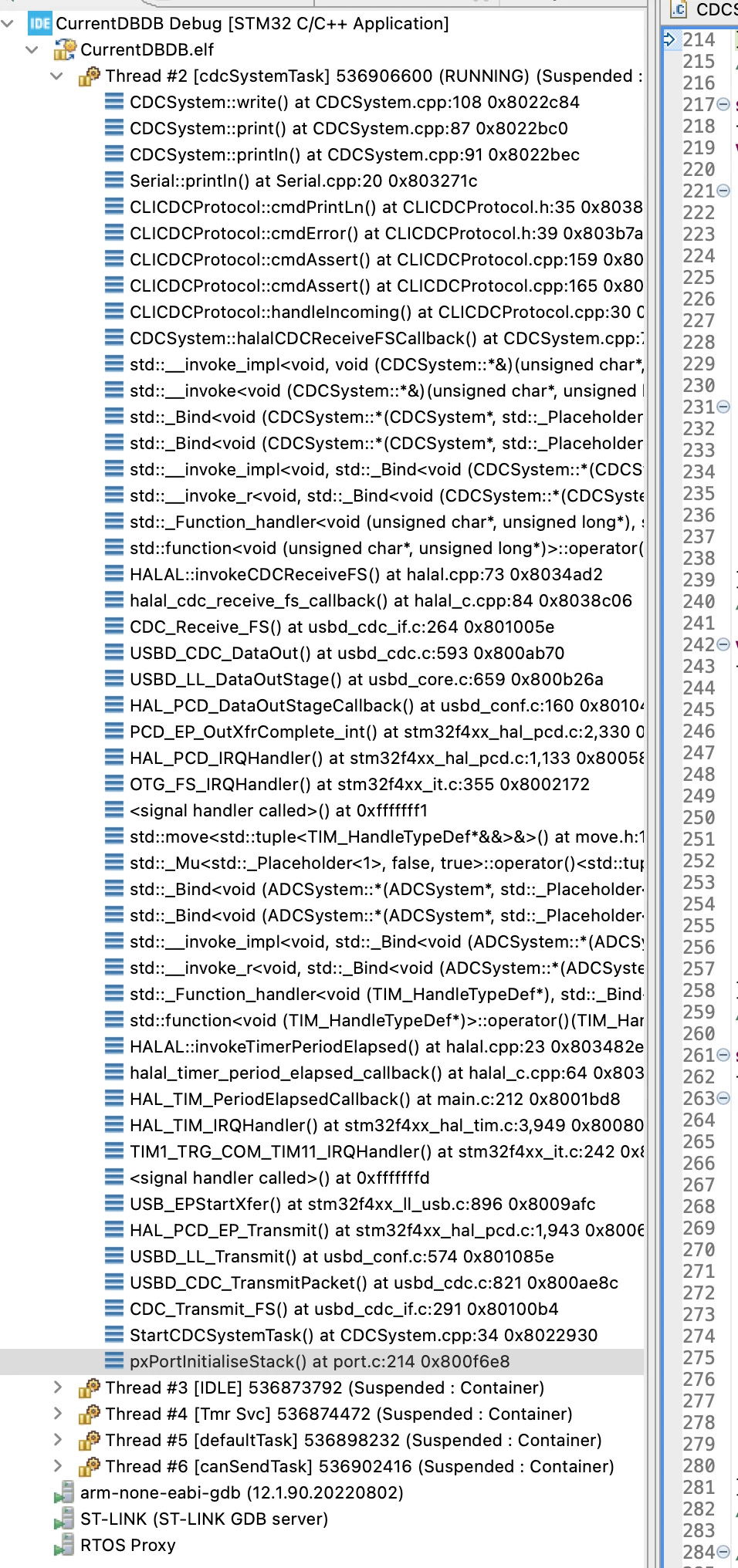

I'm experiencing a weird race condition / hangup with an application that I've built for my STM32F407VGTx. Basically I connect to the device via a USB cable and open a terminal to type commands on the device like a CLI. Everything works fine until I paste a large buffer into the console - at which point it locks up and seems to get frozen in some FreeRTOS related calls.

It seems to get stuck in the `write` method because it's unable to write all of the data to the stream (`xStreamBufferSendXXX` returns 0) - so my loop continues infinitely trying to write that data to the stream. I would expect that the task processing said stream would drain it enough so that eventually the `write` method would be able to put data into the stream.
The other thing I noticed is that when I pause the application in MXCubeIDE the `CDCSystemTask` seems to be stuck in the `write` method... (i can see that in the stack), but it should have never gotten to that method because it never does that... I assume this has something to do with YIELD and preemption?
All of my `write` methods should be called from the CDC incoming ISR.
