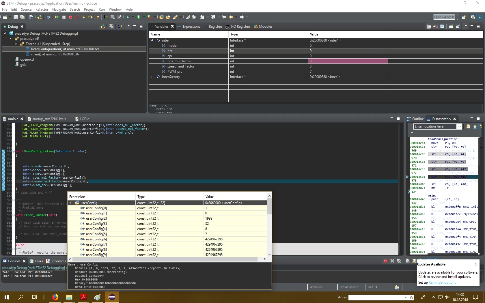

I successfully write to FLASH but when I try to read I get 0.
First I read some data from keyboard to initialize "inter" variable.
Then I store it in FLASH, but I can't read it.

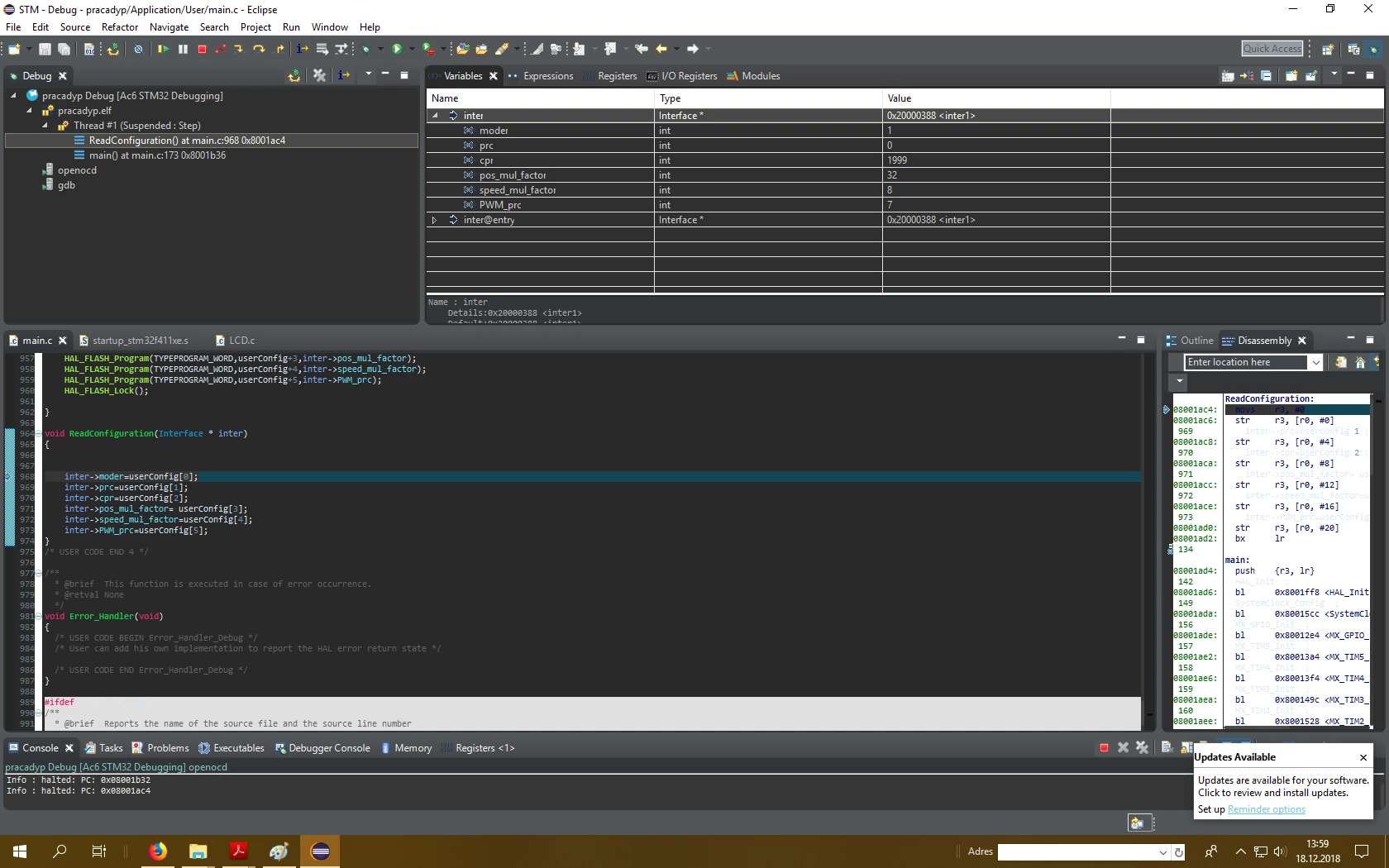

But it returns 0 on each field of "inter" variable.

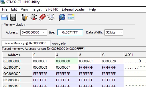

Data are stored in FLASH and I can check it in STM32 ST-LINK Utility:0690X000006CrQeQAK.png
Hera are some screens from debug perspective:
This is after reading from keyboard and writing to FLASH:
Data in userConfig[] are correct but it writes 0 to "inter" variable

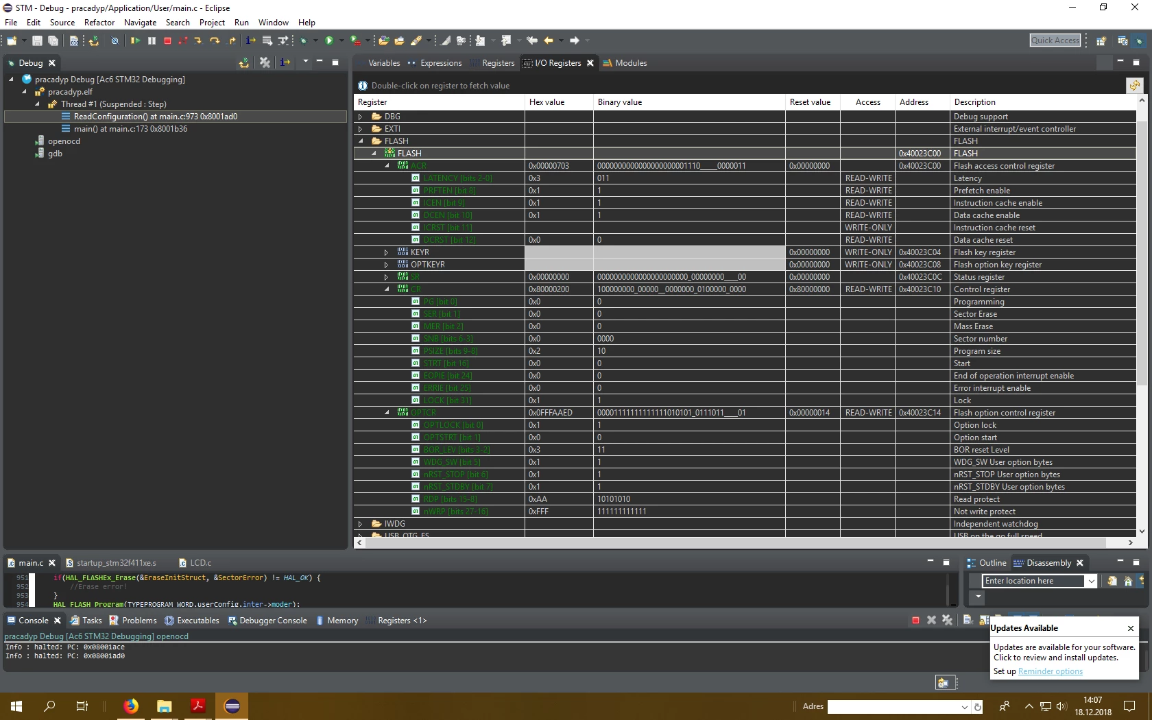

And here are FLASH registers:
The core is clocked by 100MHz so the latency is set correctly.
There is no read protection.

    Tesla DeLorean
    Tesla DeLoreanBest answer
    Guru
    Dec 18, 2018 2:05 PM UTC
    Compiler looks to be folding.
    Check the address reported in .MAP file
    Make this volatile not const

    Jake2451
    Jake2451Author
    Dec 18, 2018 3:50 PM UTC
    Thanks a lot! I've made this volatile and it works.
    The mistake comes from here: https://stackoverflow.com/a/28505272
