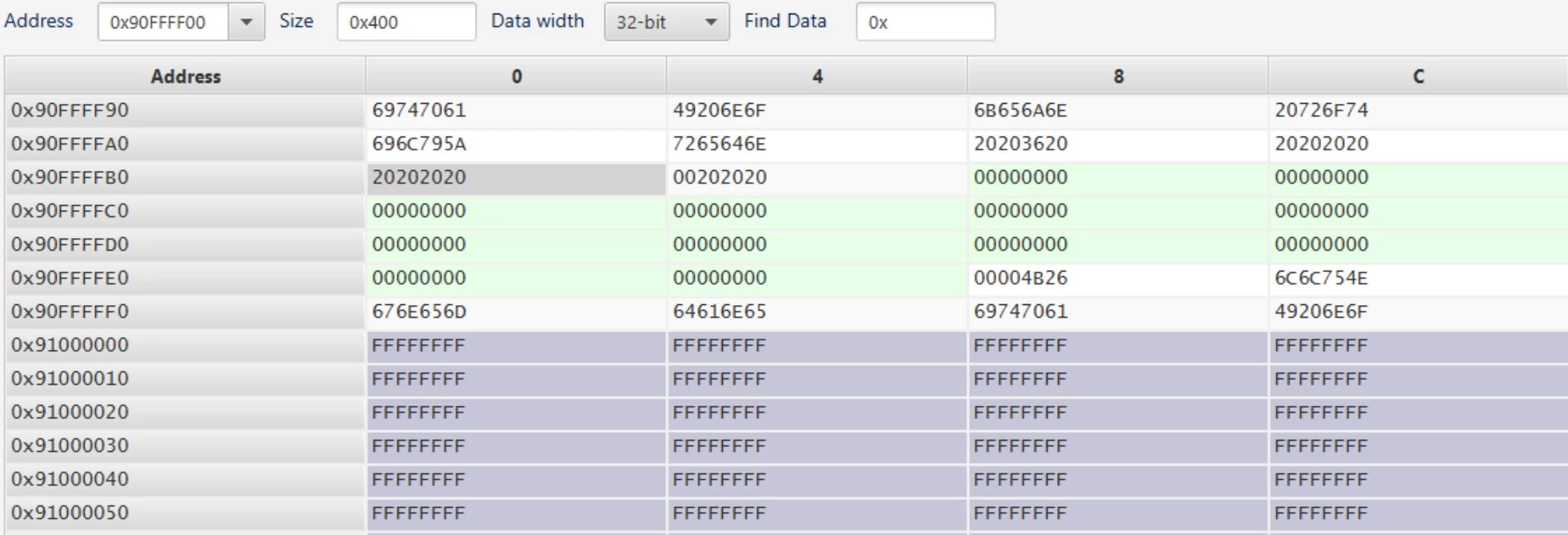

i am having problems to read data from the QSPI nor-flash if the address changes from 0x90FFFFFF to 0x91000000
Everything is fine from 0x90000000 to 0x90FFFFFF but beginning from 0x91000000 there is no data.
Example, i have an array stored at the qspi which is stored in 0x90 and it goes into the 0x91 address.

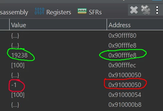

i try to copy the array to a local array which does not work. When i debug, i see that at 0x91000000 seems to be empty. Attached Screenshot 1

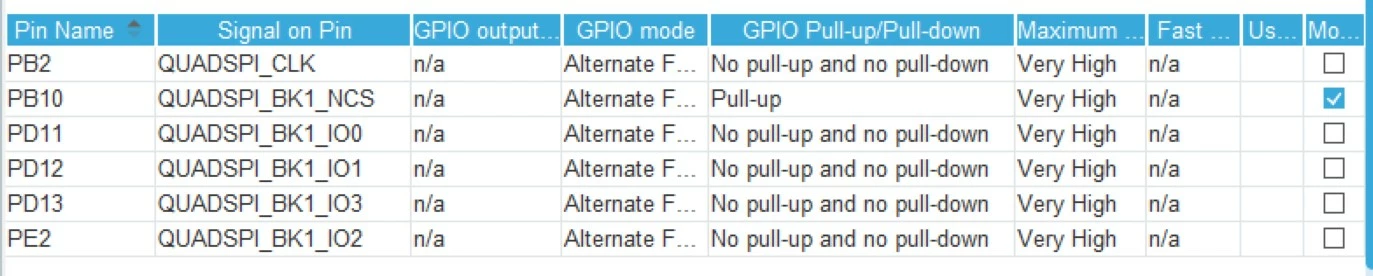

If read the with CubeProgrammer, and start from 0x90FFFF00 i see data but it also stops at 0x91000000
Attached Screenshot 2

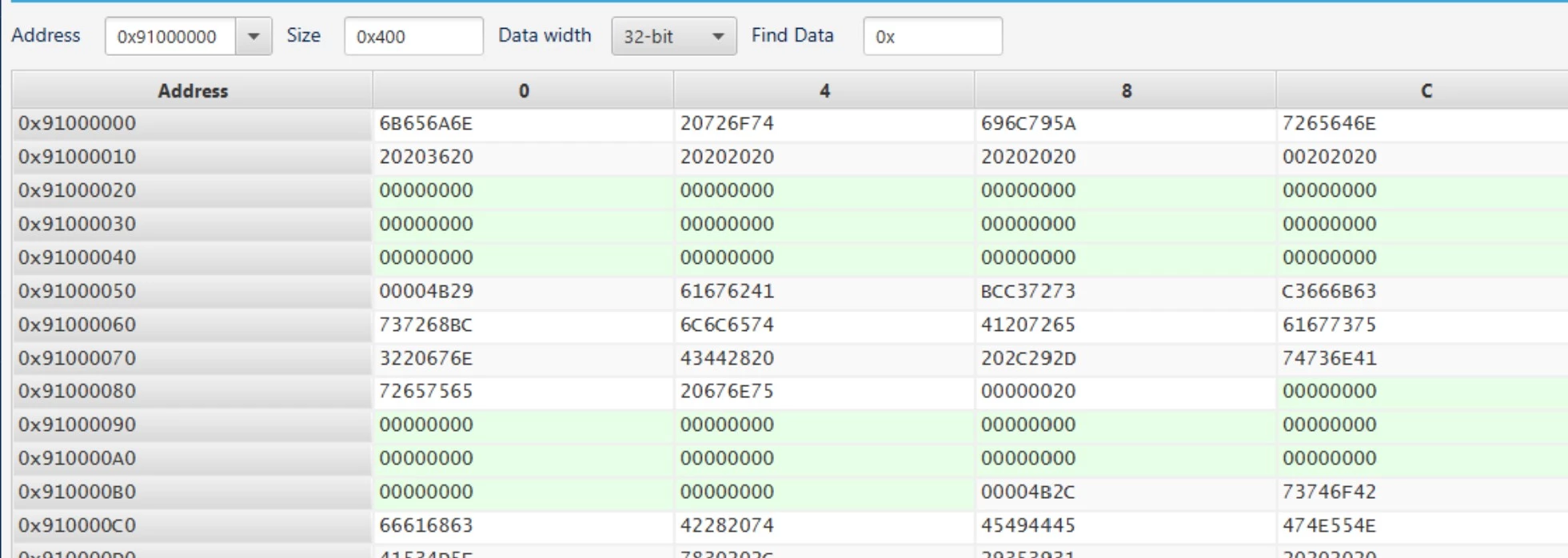

But, when starting reading from 0x91000000 i see the data correctly.
Attached Screenshot 3

The parts default into 3-byte / 24-bit addressing mode for compatibility purposes. The 3-byte addressing mode works for devices of 16MB (128Mbit) or smaller
You need to command them into 4-byte / 32-bit addressing mode, or use secondary commands identifying as being 4-byte address ones.
At the hqspi structure level this is a STM32 QSPI Peripheral directive as how to deliver the address, the flash chip needs to be in mode to accept that.
