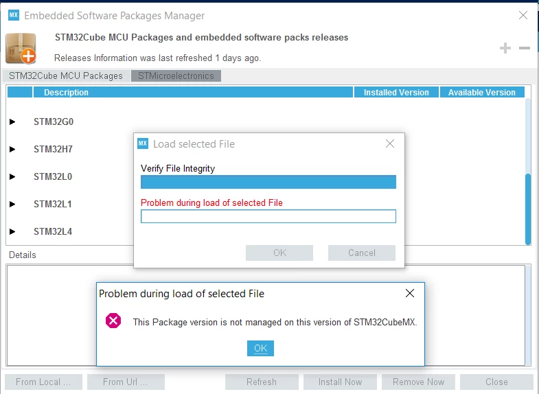

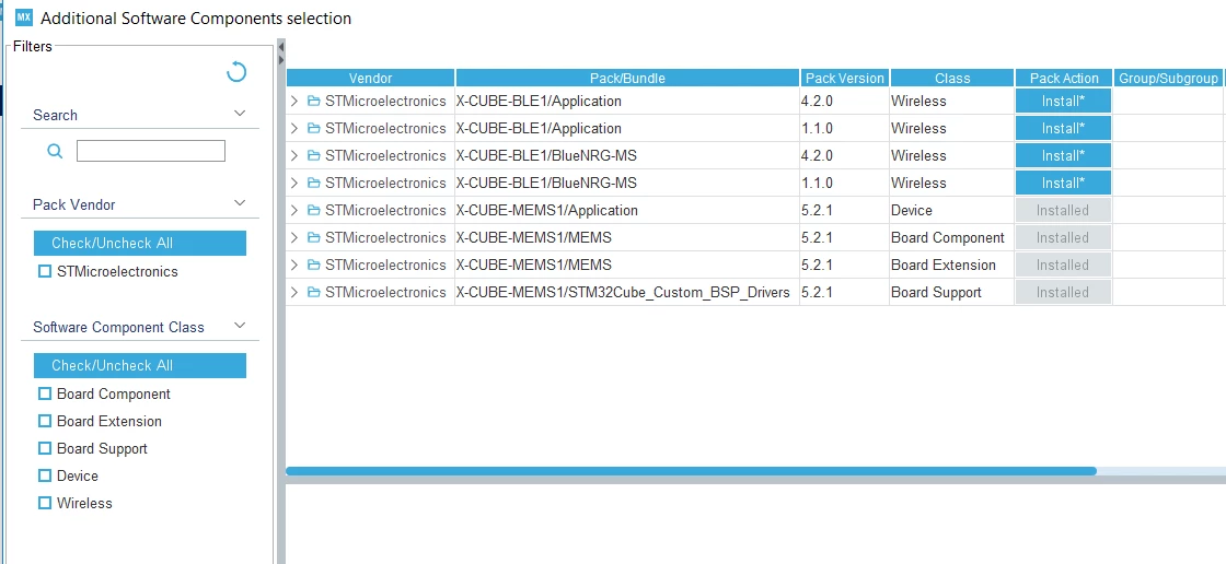

I am trying to include in my ST32CubeMX autogenerated project the 2 axis "X-CUBE-SPN2" extension to use the "X-NUCLEO-IHM02A1" board, but the package is not available in the "Additional Software Componenets".
If I downloa the package from official url and try to add using the option "Embedded Software Packages Manager/Local", ST32CubeMX always say that the package is not valid.
https://www.st.com/en/embedded-software/x-cube-spn2.html
What is wrong?, any help would be appreciated.
Thanks

    This package is not supported by CubeMX yet.
    Current supported packages by CubeMX are X-CUBE-BLE1 and X-CUBE-MEMS1.
