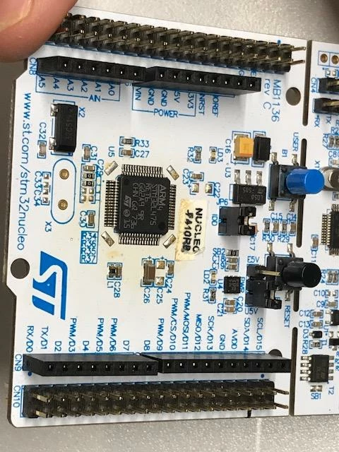

    Artem Dmitriev
    March 6, 2018
    Posted on March 06, 2018 at 07:03
    We tried to solder L475re on nucleo board. On  the board we see the same situation if we connect GPS module.
    Also we tried to connect GPS module to
    32
    L
    476
    GDISCOVERY board. In this case all work fine.
    We added additional capacitor near gate and this helped to improve step response, MCU works. But the questions is why MCU works incorrectly om 2.5V if it must work down to 1.8V?0690X00000604RoQAI.jpg

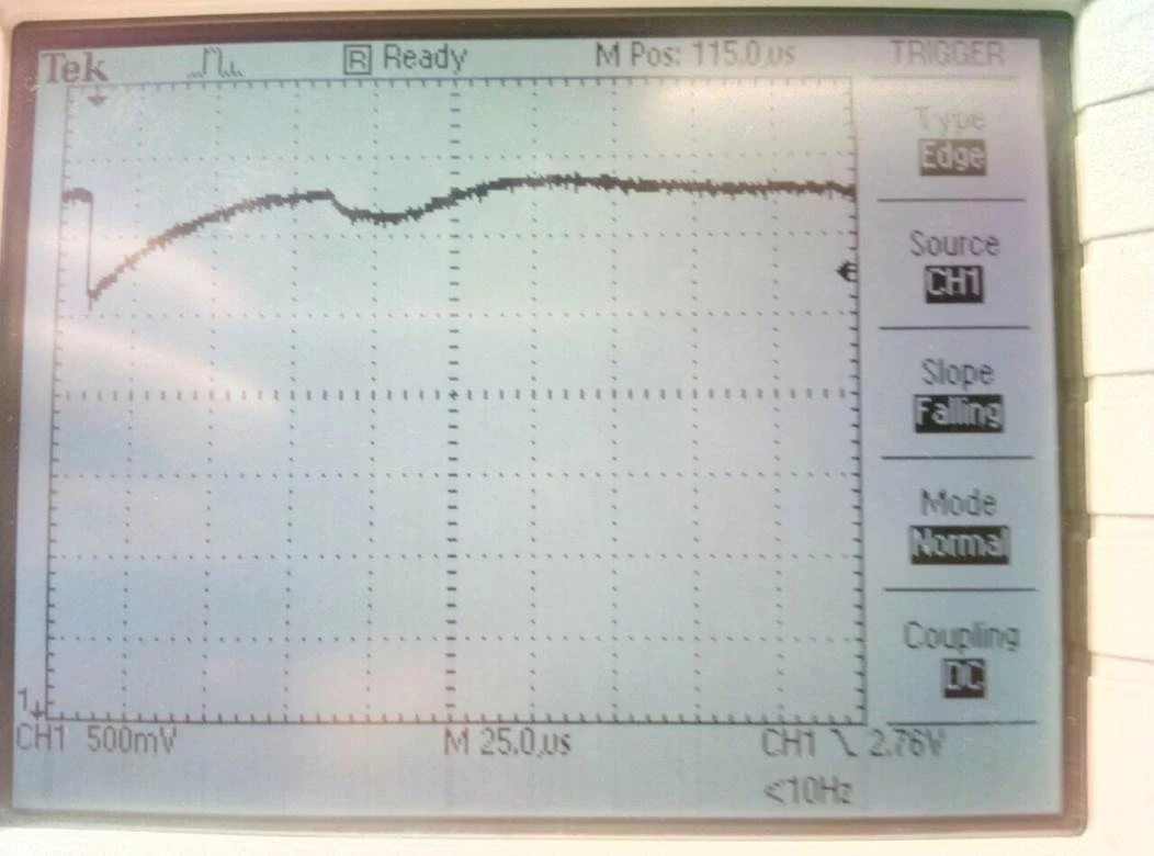

    Artem Dmitriev
    March 6, 2018
    Posted on March 06, 2018 at 09:18
    We don't see any spikes on oscillograph.
    MCU works from 1.8V with connected GPS module. But GPS working voltages are 2.8 �?´�?¾ 4.3 V.  On voltages up to 2.8V GPS module doesn't work, voltage drop exists, but MCU works fine. If we connect GPS using voltages 2.8 to 3.6 MCU works incorrectly.
