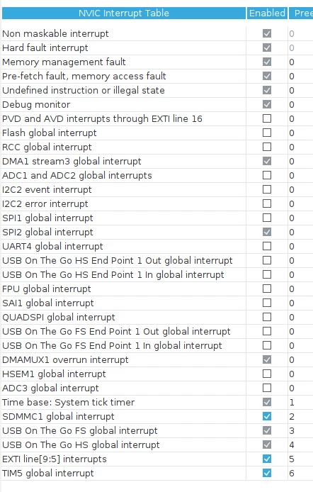

wrong? i dont know. :)  but i have usb sticks (all, i tested, 1GB up to 64GB exfat) working ok.
on H743 , so probably same usb module.
i set port speed to medium, to reduce reflections:
try this.

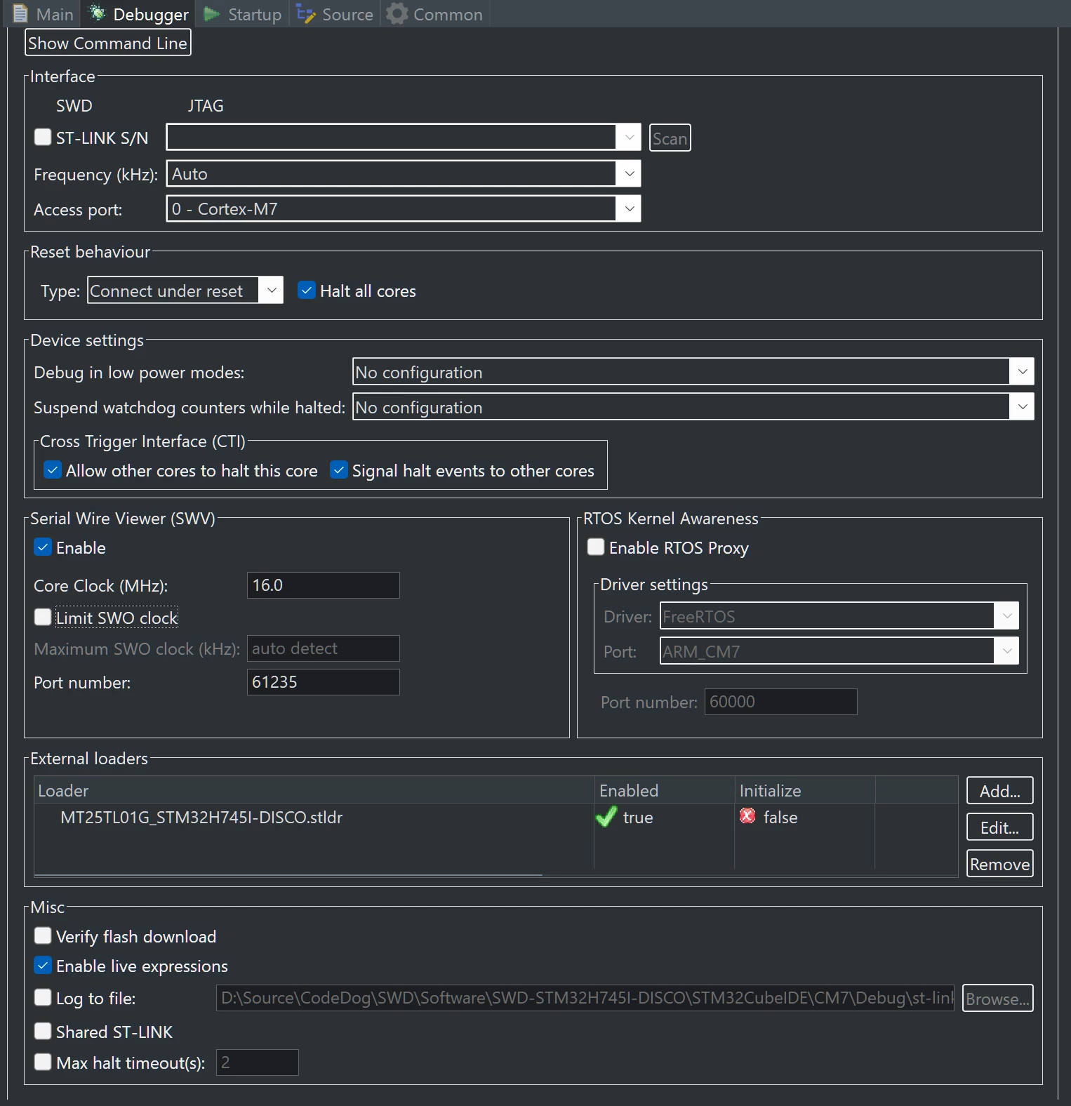

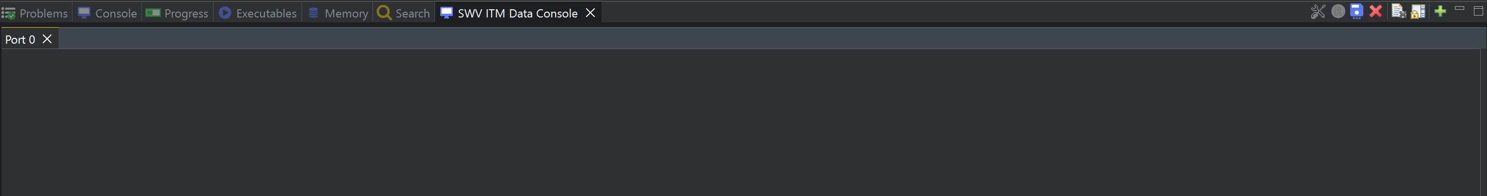

Here's my SWV configuration:
It shows nothing in any view.
I also tried to find the "USB Device Connected" text, I put a breakpoint there. The line is not called when the completely not working stick is used. It is called on some of the semi-working ones.
My guess something wrong happens before even USB Host starts. The sticks (not working ones) seem to behave randomly. I mean - some of them try to disconnect on start. One disconnects, reconnects, then even starts MSC class, then fails miserably when trying to mount the filesystem. One of them just doesn't trigger anything. Like no connection attempt, no disconnection. Their behavior changes to other random pattern of connection / disconnection when I change the USB clock to something other than 48MHz. However, my only working stick works when the frequency is set to 48-50MHz, doesn't work with any other frequency. When it doesn't work - it triggers the connection event all the time when it's inserted (like in a loop). When it's not physically present - no events, when it's present, I get connection attempts one after another.

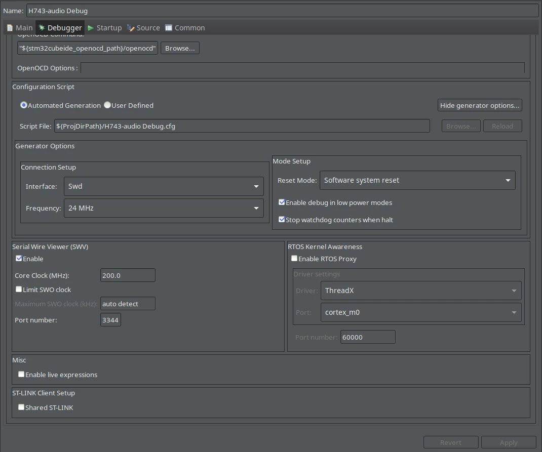

to get swv running was a long game...many hours.
1. swo is connected on your board ?
2. you set it in Cube... ?
3. you set core frequ. wrong - then its not working.
here my set: (with open ocd, but that should not be important)

another problem: int priority - i just show you my working setting , i use no dma template, this i never got working:
i have sdcard and 2x usb host running, 1 usb msc (memory stick) and 1x usb audio host (not working, but STM has no working example, so difficult to make it run) and no dma on all, because problem with d-cache on H7 cpus.
test : switch off d-cache (dont enable it ) - makes any difference ?
