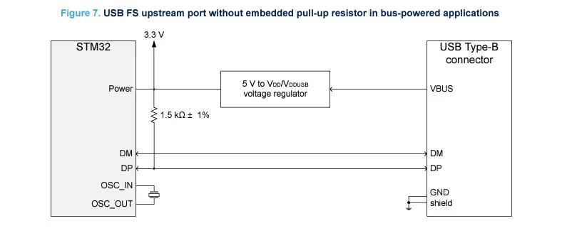

2) On bread board, we decided to test it before going for PCB board. First we tried the following connection (this is taken directly from STM's website):
When we put the pull-up resistor, the PC recognizes a USB device is inserted but we get "USB Device driver not recognized" error (testing the DP via ossiloscope, we saw some information sent). With external pull-up resistor like this, we see 3.3V on ossiloscope in DP pin.
When we try without external pull-up resistor (activating the internal pull-up resistors from the cubeIDE), the PC does not recognize USB port at all in device manager. With internal pull-up resistors activated, we see around 1V on ossilioscope in DP pin.

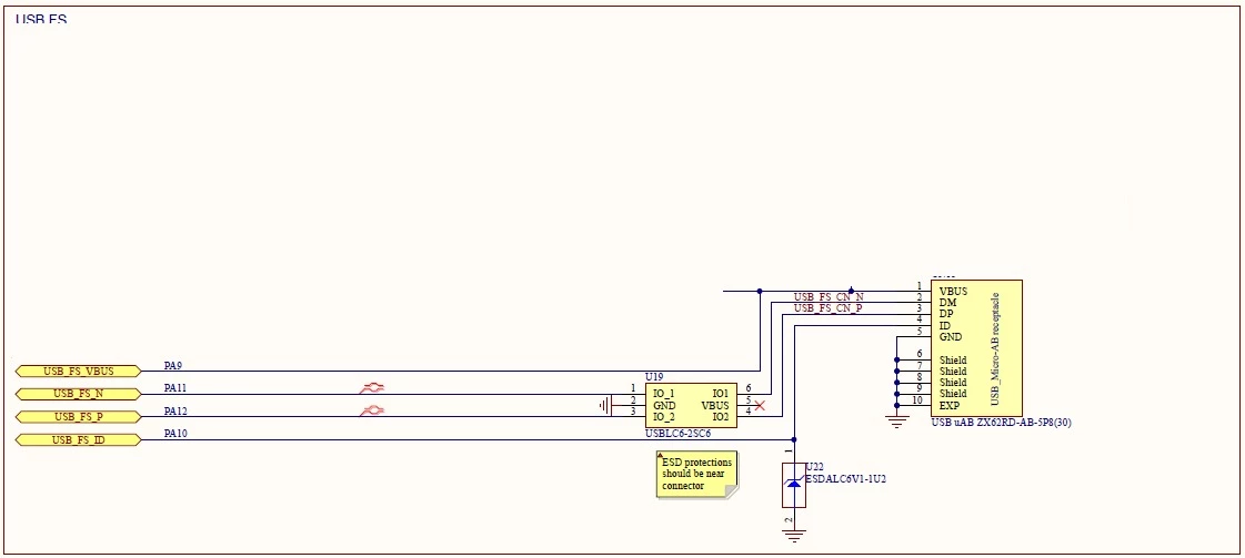

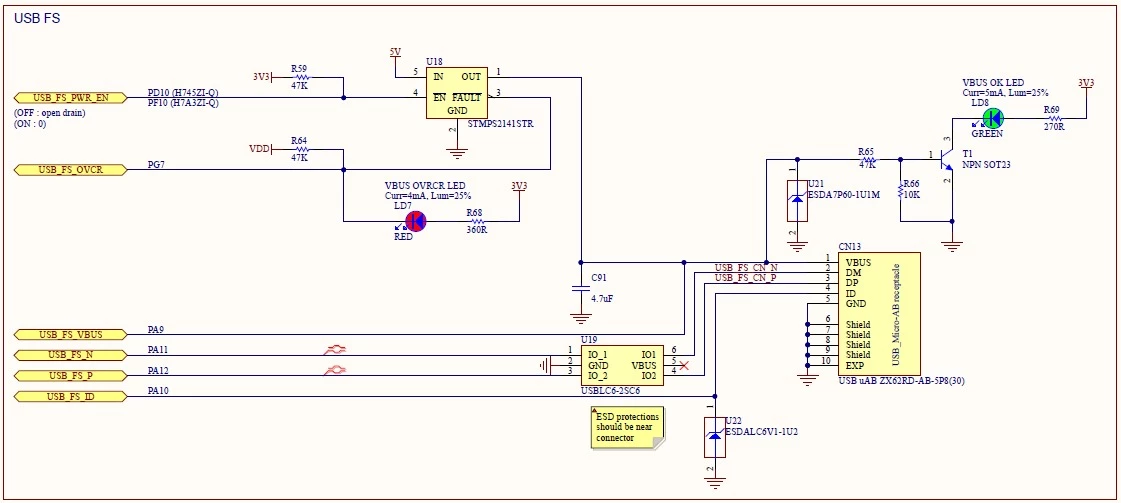

2) We then decided to test the following schematics, which we found in some forum somewhere:
However, because we lack certain integrated circuits and we consider ourselves smart engineers ("this part of the circuit isn't necessary anways") we tested it as follows:
In this setup, the PC does not recognize the USB device at all. Mind that internal pull-up resistors are not activated in this setup (but even if we activate them, it doesn't work - we tried).

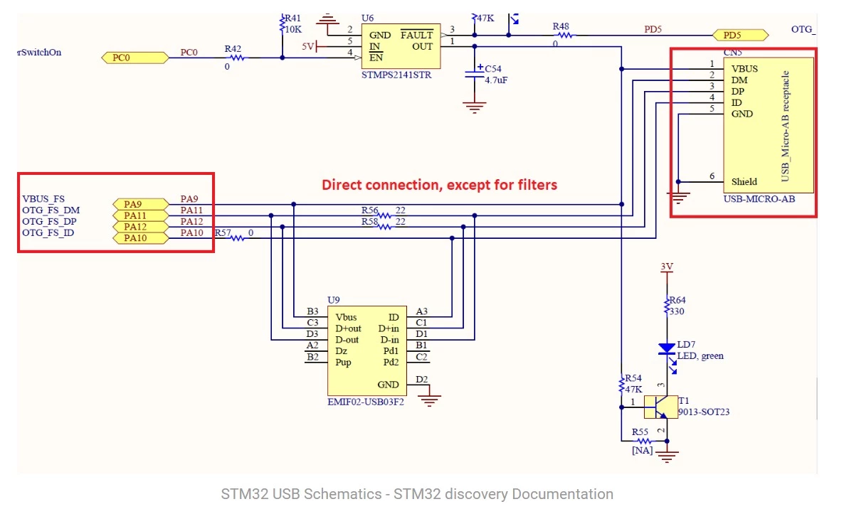

3) We then get the following idea: "If the development board is working, why don't we replicate the development board's schematic exactly? This is surefire way to make it work!". So we pulled up the schematics of the dev board:

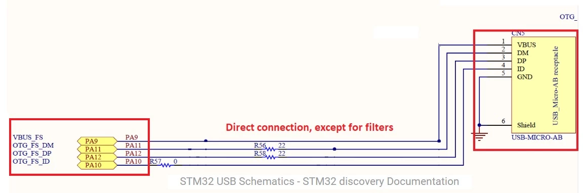

But again, because we are geniuses and a LED light is obviously not compulsory for the circuit to work, we decided to test the following only:
Again, in this setup, the USB is not recognized at all on device manager.

You wrote only about the USB connection, but is the clock good for USB? The on-board ST-Link of Nucleo usually provides its clock to the STM32 in 'single-ended' mode. On your scheme there's a different thing - external crystal.
Hopefully this medical device is not of a life-critical type...
Visitor II
December 25, 2023
Use debugging tools to inspect the USB signals, such as a logic analyzer or oscilloscope. Check the signal integrity and voltage levels on the D+ and D- lines during device enumeration.
