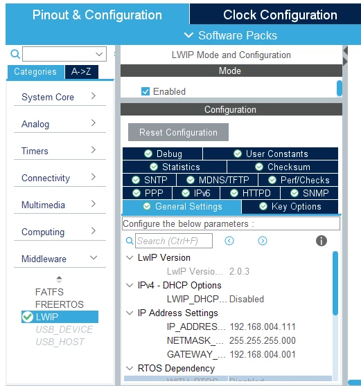

I am using the STM32F107VCT6 controller. use STMcubeIDE.
I write the code of the UDP Server. but when I change the IP, subnet, and Gateway using TCP and reset the device. I do not get Broadcast info or the udp_recv function not working.LWIP.PNG

> err = udp_bind(upcb, IP_ADDR_ANY , 1225); // 7 is the server UDP port
Which is it - port 1225 or port 7?
What IP/mask/gateway values worked?  What are the IP address/mask/gateway settings of the device sending the UDP broadcast?
GETANSAuthor
March 14, 2024
IP : 192.168.4.111
Subnetmask : 255.255.255.0
Gateway : 192.168.4.1
and port : 1225
Bob S
March 15, 2024
Maybe I mis-understood your original post because you re-posted the same IP address as in your first post.  Did this code EVER work?  To me it sounded like it worked, and then you changed the IP address and it stopped working.
If it DID work and now does not - provide BOTH the original IP address info and new IP address info
What is the IP address of the device that is sending the UDP broadcasts?
What does your program print on the serial port?
Do you call MX_LwIP_Process() somewhere in your main loop?
