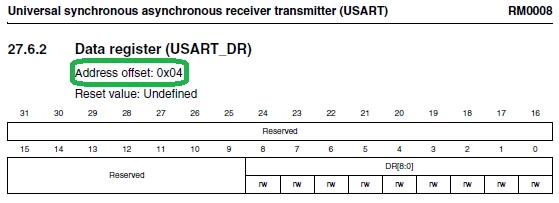

    By the way, I do not really understand why
    (uint32_t)SERIAL_UART + 0x04
    not 0x00?

    The DR (Data Register) is not at the base of the peripheral, it's offset. You could always use &USART1->DR if you wanted some clarity. Review the Reference Manual for your part.
