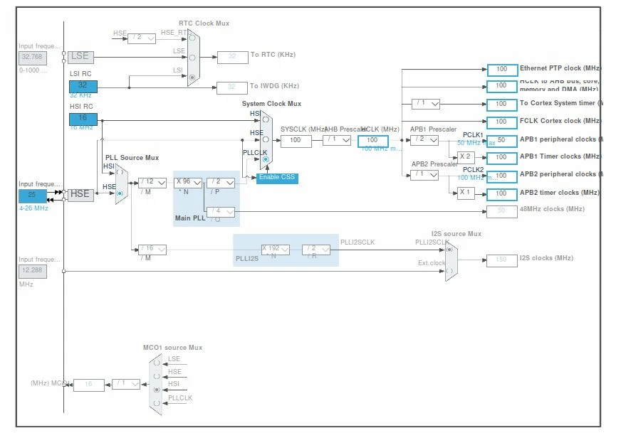

    In your case, you are correct - your timer IRQ is starving the CPU.  I don't think your timer IRQ is really getting called every 16 CPU cycles - that is just not possible if the IRQ function does ANYTHING.  Just pushing registers on the stack and then popping them back off probably takes longer than that.
    If your PWM freq is 12MHz and it counts to 8 before resetting/reloading, that is a PWM period of 12MHz/8 = 1.5MHz.  And an IRQ at "half complete" would be 2 PWM periods, or 0.75MHz (750KHz).  The CPU should be able to handle THAT interrupt rate, unless your callback has lots of code in it.
    July 6, 2023
    I Apologize for that.
    Sorry I have missed multipler 2x which is before Timer clock on  APB1 bus.
    So Timer4 have 100MHz clock, So 1 Tick is 10ns.
    As per my calculations for 12.5MHz T=80ns , so 8 Ticks gives us 80ns.
    Therefore Counter Period = 8-1 and Pulse Value = 4.

    Oh man, THAT ^^^ is not correct.  Let me try again...  Your original post said:
    > 100MHz CPU clock and 50MHz Timer 4 clock with the PWM output on
    > Channel 3 of 12MHz, timer count 8 and pulse count 4.
    Hmmm... 50MHz TIM4 clock with a (I presume max) count of 8 does not give you 12MHz PWM freq.  It gives you 12MHz/8 = 1.5 MHz.  And there is no way to get a 12 MHz PWM from a 50 MHz timer clock (would need to divide by 4.167.  So maybe divide by 4 to get 12.5 MHz?
    So, yeah, as @Karl Yamashita said - post your code - UART and timer config so we can see what your PWM is really doing, plus your timer and dma IRQ callbacks and any code that deals with the UART.
    July 6, 2023
    Sorry I have multipler 2x which is before Timer clock on  APB1 bus.
    Please find full details in reply section https://community.st.com/t5/stm32cubeide-mcu/problem-with-uart-transmission-while-timer-interrupt-is...

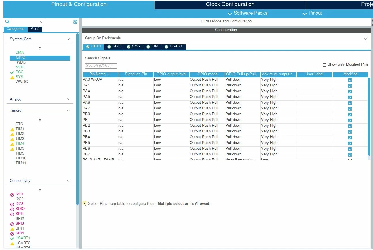

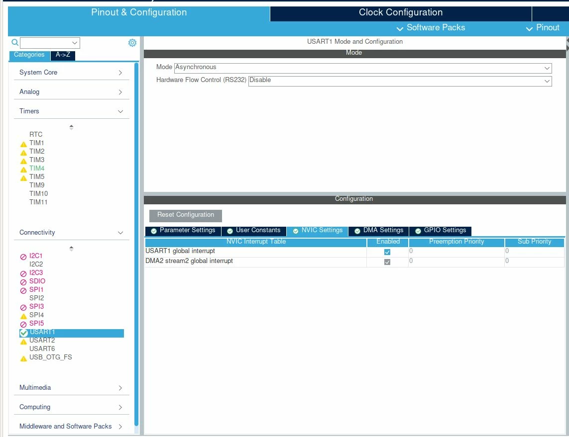

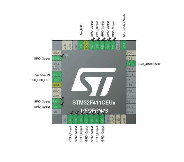

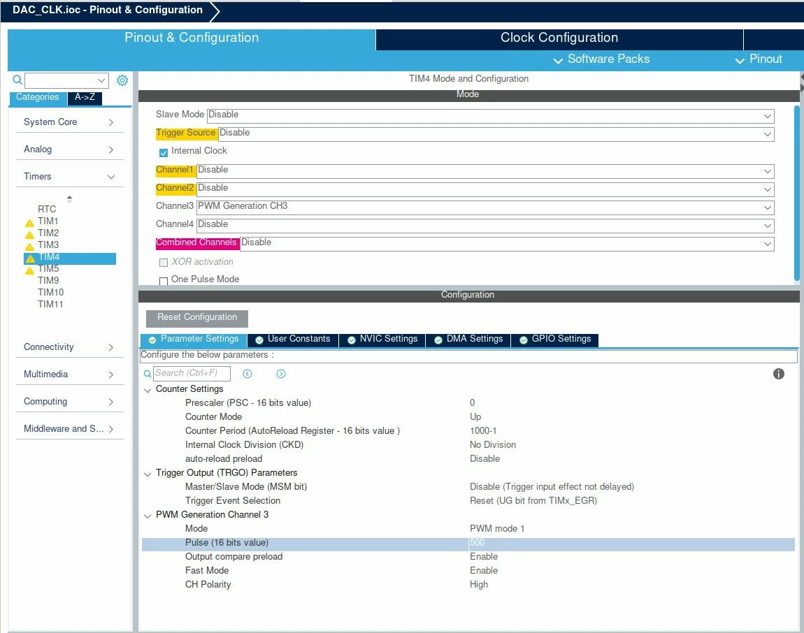

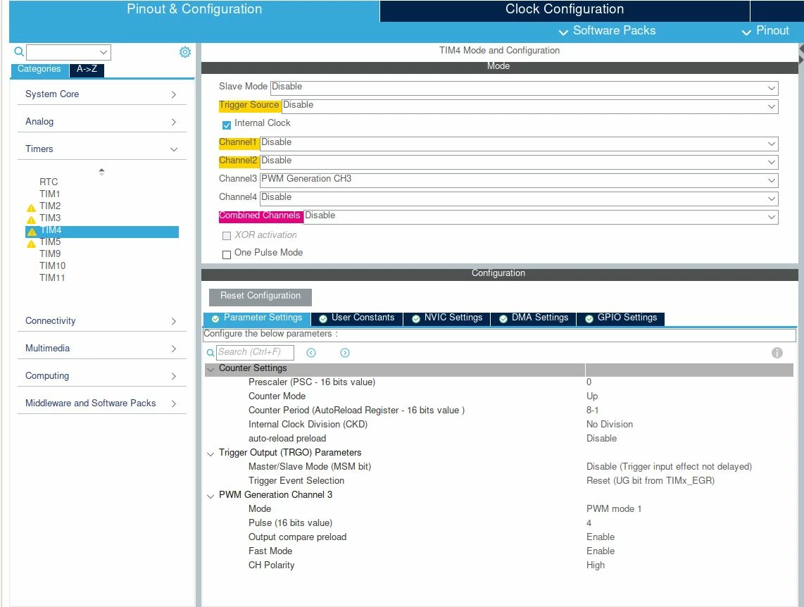

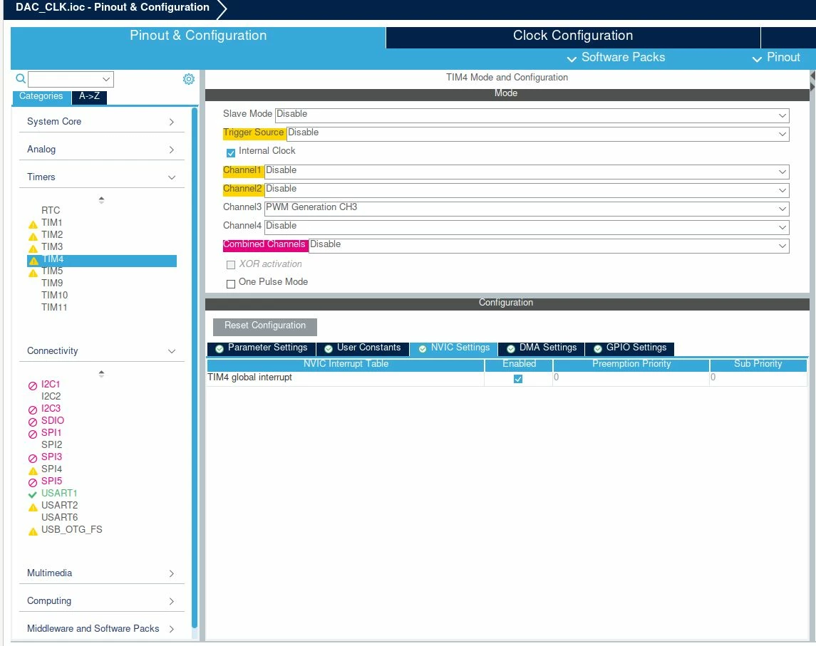

    July 6, 2023

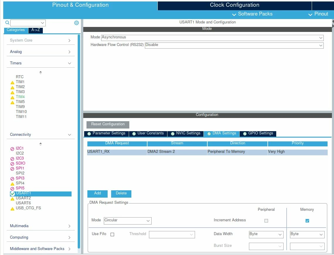

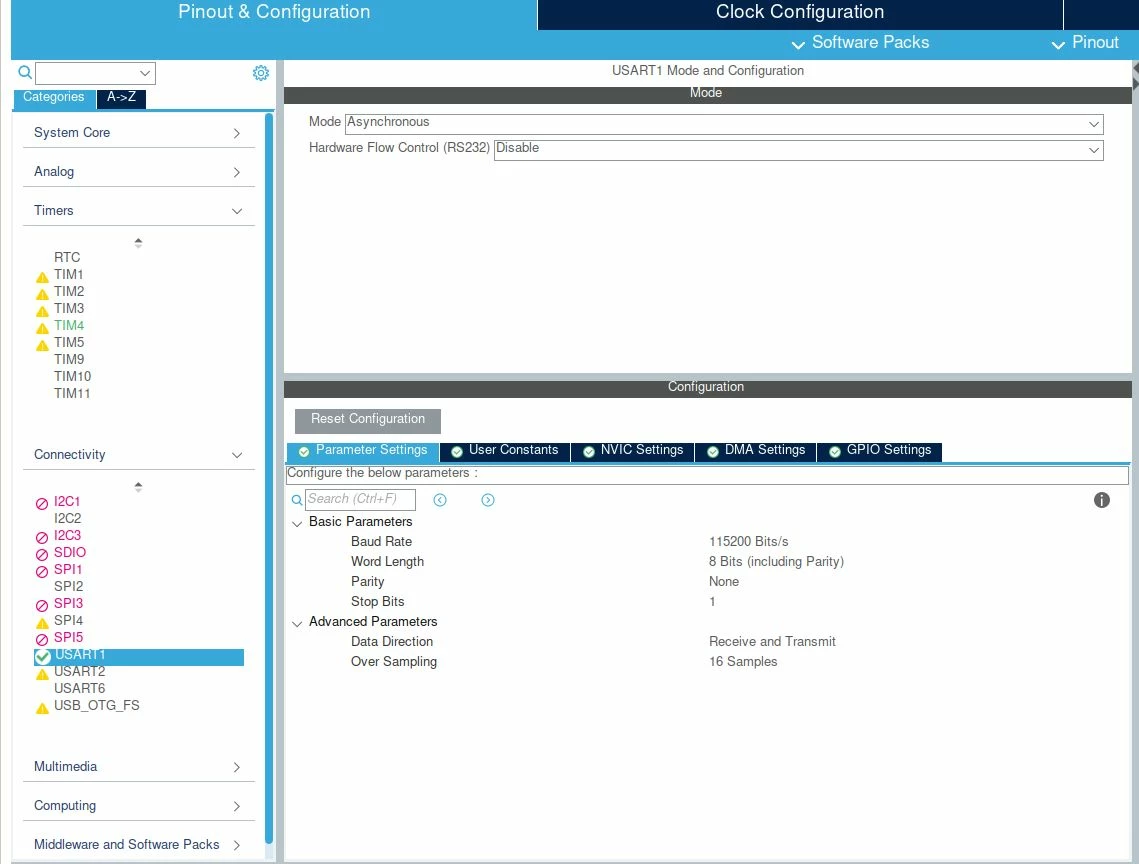

    I think I missed the problem explanation, sorry for that.
    Please find the detailed information below -
    To Achieve -
    1- Need to create DAC (Digital to Analog) Interface.
    2- Receive data from UART ( I have chosen UART because of DMA support) (USB option is also available but I think DMA support option is not available on STCube IDE).
    3- Send the data (received from UART) to DAC which is connected to GPIOA (A0 to A7) LSB and GPIOB MSB (B0 to B7)
    4- Generate CLK of 12MHz / 12.5MHz.
    Facing issues -
     1- Unable to receive data when the PWM timer interrupt is enabled (using this function in main.c file - HAL_TIM_PWM_Start_IT(&htim4, TIM_CHANNEL_3);
    but , getting data when I disabled the PWM timer interrupt (HAL_TIM_PWM_Start(&htim4, TIM_CHANNEL_3);.
    I have done calculation for timer 4 to generate CLK, the details -
    APB1 Timer Clock :- 100MHz, so T=10ns.
    1 Tick = 10ns, so for 12.5MHz, T=80ns.
    Therefore Counter Period = 8 Ticks.
    For 50% duty cycle Pulse value = 4.
    Please see the reference image 01 -
    Pin ConfigPin ConfigCLK ConfigCLK ConfigGPIO ConfigGPIO ConfigTimer4 ConfigTimer4 ConfigUART1 ConfigUART1 ConfigUART1 DMA ConfigUART1 DMA ConfigUART1 NVIC ConfigUART1 NVIC ConfigTimer4 NIVC ConfigTimer4 NIVC Config

    static void MX_TIM4_Init(void) {
    	/* USER CODE BEGIN TIM4_Init 0 */
    	/* USER CODE END TIM4_Init 0 */
    	TIM_ClockConfigTypeDef sClockSourceConfig = { 0 };
    	TIM_MasterConfigTypeDef sMasterConfig = { 0 };
    	TIM_OC_InitTypeDef sConfigOC = { 0 };
    	/* USER CODE BEGIN TIM4_Init 1 */
    	/* USER CODE END TIM4_Init 1 */
    	htim4.Instance = TIM4;
    	htim4.Init.Prescaler = 0;
    	htim4.Init.CounterMode = TIM_COUNTERMODE_UP;
    	htim4.Init.Period = 8 - 1;
    	htim4.Init.ClockDivision = TIM_CLOCKDIVISION_DIV1;
    	htim4.Init.AutoReloadPreload = TIM_AUTORELOAD_PRELOAD_DISABLE;
    	if (HAL_TIM_Base_Init(&htim4) != HAL_OK) {
    		Error_Handler();
    	sClockSourceConfig.ClockSource = TIM_CLOCKSOURCE_INTERNAL;
    	if (HAL_TIM_ConfigClockSource(&htim4, &sClockSourceConfig) != HAL_OK) {
    		Error_Handler();
    	if (HAL_TIM_PWM_Init(&htim4) != HAL_OK) {
    		Error_Handler();
    	sMasterConfig.MasterOutputTrigger = TIM_TRGO_RESET;
    	sMasterConfig.MasterSlaveMode = TIM_MASTERSLAVEMODE_DISABLE;
    	if (HAL_TIMEx_MasterConfigSynchronization(&htim4, &sMasterConfig)
    			!= HAL_OK) {
    		Error_Handler();
    	sConfigOC.OCMode = TIM_OCMODE_PWM1;
    	sConfigOC.Pulse = 4;
    	sConfigOC.OCPolarity = TIM_OCPOLARITY_HIGH;
    	sConfigOC.OCFastMode = TIM_OCFAST_ENABLE;
    	if (HAL_TIM_PWM_ConfigChannel(&htim4, &sConfigOC, TIM_CHANNEL_3)
    			!= HAL_OK) {
    		Error_Handler();
    	/* USER CODE BEGIN TIM4_Init 2 */
    	/* USER CODE END TIM4_Init 2 */
    	HAL_TIM_MspPostInit(&htim4);

     * Enable DMA controller clock
    static void MX_DMA_Init(void) {
    	/* DMA controller clock enable */
    	__HAL_RCC_DMA2_CLK_ENABLE();
    	/* DMA interrupt init */
    	/* DMA2_Stream2_IRQn interrupt configuration */
    	HAL_NVIC_SetPriority(DMA2_Stream2_IRQn, 0, 0);
    	HAL_NVIC_EnableIRQ(DMA2_Stream2_IRQn);

    	HAL_GPIO_Init(GPIOA, &GPIO_InitStruct);
    	/*Configure GPIO pins : PB0 PB1 PB2 PB3
    	 PB4 PB5 PB6 PB7 */
    	GPIO_InitStruct.Pin = GPIO_PIN_0 | GPIO_PIN_1 | GPIO_PIN_2 | GPIO_PIN_3
    			| GPIO_PIN_4 | GPIO_PIN_5 | GPIO_PIN_6 | GPIO_PIN_7;
    	GPIO_InitStruct.Pull = GPIO_PULLDOWN;
    	GPIO_InitStruct.Speed = GPIO_SPEED_FREQ_VERY_HIGH;
    	HAL_GPIO_Init(GPIOB, &GPIO_InitStruct);
    	/* USER CODE BEGIN MX_GPIO_Init_2 */
    	/* USER CODE END MX_GPIO_Init_2 */
    /* USER CODE BEGIN 4 */
    //Whem using received data from UART
    //void HAL_TIM_PWM_PulseFinishedHalfCpltCallback(TIM_HandleTypeDef *htim) {
    //	GPIOA->ODR = (uint32_t) (rx_buf[i] & 0x00FF);
    //	GPIOB->ODR = (uint32_t) ((rx_buf[i + 1]) & 0x00FF);
    //	i++;
    //	if (i == 100)
    //		i = 0;
    //only to check Whether connections are ok!
    	GPIOA->ODR = (uint32_t) (buf[i] & 0x00FF);
    	GPIOB->ODR = (uint32_t) ((buf[i] >> 8) & 0x00FF);
    	i++;
    	if (i == 4)
    		i = 0;
    void HAL_UART_RxCpltCallback(UART_HandleTypeDef *huart)
    	HAL_UART_Receive_DMA(&huart1, rx_buf, sizeof(rx_buf));
    /* USER CODE END 4 */

     stm32f4xx_it.c program
    these two functions modified -
    1- void USART1_IRQHandler(void)
    2- void DMA2_Stream2_IRQHandler(void)

     * @brief This function handles TIM4 global interrupt.
    void TIM4_IRQHandler(void)
     /* USER CODE BEGIN TIM4_IRQn 0 */
     /* USER CODE END TIM4_IRQn 0 */
     HAL_TIM_IRQHandler(&htim4);
     /* USER CODE BEGIN TIM4_IRQn 1 */
     HAL_TIM_PWM_PulseFinishedHalfCpltCallback(&htim4);
     /* USER CODE END TIM4_IRQn 1 */
     * @brief This function handles USART1 global interrupt.
     /* USER CODE BEGIN USART1_IRQn 0 */
     /* USER CODE END USART1_IRQn 0 */
     HAL_UART_IRQHandler(&huart1);
     /* USER CODE BEGIN USART1_IRQn 1 */
     HAL_UART_RxCpltCallback(&huart1);
     /* USER CODE END USART1_IRQn 1 */
     * @brief This function handles DMA2 stream2 global interrupt.
     /* USER CODE BEGIN DMA2_Stream2_IRQn 0 */
     /* USER CODE END DMA2_Stream2_IRQn 0 */
     HAL_DMA_IRQHandler(&hdma_usart1_rx);
     /* USER CODE BEGIN DMA2_Stream2_IRQn 1 */
     /* USER CODE END DMA2_Stream2_IRQn 1 */

    July 6, 2023
    Once I reduces the PWM CLK Frequncy by modifing Couter Period to 1000 Ticks and Pules Value to 500. UART can receive data and than Half Pulse Complete Interrupt writes this data to GPIOA->ODR and GPIOB->ODR registor.
    Timer Config For 100KHz CLKTimer Config For 100KHz CLK

    void SystemClock_Config(void)
     __HAL_RCC_PWR_CLK_ENABLE();
     __HAL_PWR_VOLTAGESCALING_CONFIG(PWR_REGULATOR_VOLTAGE_SCALE1);
     RCC_OscInitStruct.OscillatorType = RCC_OSCILLATORTYPE_HSE;
     RCC_OscInitStruct.HSEState = RCC_HSE_ON;
     RCC_OscInitStruct.PLL.PLLSource = RCC_PLLSOURCE_HSE;
     RCC_OscInitStruct.PLL.PLLM = 12;
     RCC_OscInitStruct.PLL.PLLN = 96;
     RCC_OscInitStruct.PLL.PLLP = RCC_PLLP_DIV2;
     RCC_OscInitStruct.PLL.PLLQ = 4;
     Error_Handler();
     RCC_ClkInitStruct.APB1CLKDivider = RCC_HCLK_DIV2;
     RCC_ClkInitStruct.APB2CLKDivider = RCC_HCLK_DIV1;
     if (HAL_RCC_ClockConfig(&RCC_ClkInitStruct, FLASH_LATENCY_3) != HAL_OK)
     Error_Handler();
     TIM_ClockConfigTypeDef sClockSourceConfig = {0};
     TIM_MasterConfigTypeDef sMasterConfig = {0};
     TIM_OC_InitTypeDef sConfigOC = {0};
     htim4.Init.Period = 1000-1;
     Error_Handler();
     Error_Handler();
     Error_Handler();
     if (HAL_TIMEx_MasterConfigSynchronization(&htim4, &sMasterConfig) != HAL_OK)
     Error_Handler();
     sConfigOC.Pulse = 500;
     if (HAL_TIM_PWM_ConfigChannel(&htim4, &sConfigOC, TIM_CHANNEL_3) != HAL_OK)
     Error_Handler();

    static void MX_USART1_UART_Init(void)
     /* USER CODE BEGIN USART1_Init 0 */
     /* USER CODE END USART1_Init 0 */
     /* USER CODE BEGIN USART1_Init 1 */
     /* USER CODE END USART1_Init 1 */
     huart1.Instance = USART1;
     huart1.Init.BaudRate = 115200;
     huart1.Init.WordLength = UART_WORDLENGTH_8B;
     huart1.Init.StopBits = UART_STOPBITS_1;
     huart1.Init.Parity = UART_PARITY_NONE;
     huart1.Init.Mode = UART_MODE_TX_RX;
     huart1.Init.HwFlowCtl = UART_HWCONTROL_NONE;
     huart1.Init.OverSampling = UART_OVERSAMPLING_16;
     if (HAL_UART_Init(&huart1) != HAL_OK)
     Error_Handler();
     /* USER CODE BEGIN USART1_Init 2 */
     /* USER CODE END USART1_Init 2 */
