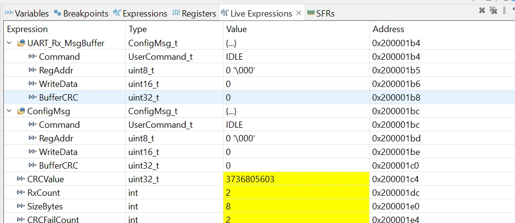

The image below shows the Live Expressions window:
I'm experiencing an issue where the UART reception seems to split the incoming data into multiple callbacks, even though the data is being sent in a single transmission. Specifically:
  • When I use HAL_UARTEx_ReceiveToIdle_DMA(&huart4, (uint8_t*)&UART_Rx_MsgBuffer, sizeof(UART_Rx_MsgBuffer));, the data appears fragmented, and I observe unexpected zeros in the received buffer.
  • When I increase the size of the receive buffer to (sizeof(UART_Rx_MsgBuffer) + 9), the problem seems to resolve, and the data is received correctly in one callback. However, it only works for the the first reception and doesn't work afterwards.
My questions are:
  1. Why is the data being split across multiple callbacks (RxCount = 2) when using the smaller buffer size?
  2. What is causing the extra zeros to appear in the received data?
  3. Why does increasing the buffer size seem to fix the issue, and how can I ensure reliable reception without relying on an oversized buffer?
  4. Shouldn't an early idle line trigger result in the received data being split differently, with no extra zeros?
Any insights or suggestions on how to properly configure the UART to avoid this issue would be greatly appreciated!

Hello Karl,
Thank you for your reply. I have tried disabling the interrupt in the following ways and have received varying results, which are listed below:
  • Disabling the HT Interrupt before starting the reception:
Code:
/* USER CODE BEGIN 2 */
 __HAL_DMA_DISABLE_IT(&handle_GPDMA1_Channel0, DMA_IT_HT);
 printf("RxCount - %u: \t ", RxCount);
 for(int i = 0; i<sizeof(RxSampleBuffer); i++){
	 RxSampleBuffer[i] = 255;
	 printf("%u \t", RxSampleBuffer[i]);
 printf("\n");
 HAL_UARTEx_ReceiveToIdle_DMA(&huart4, (uint8_t*)&UART_Rx_MsgBuffer, sizeof(ConfigMsg_t));
/* USER CODE END 2 */
 /* Infinite loop */
Output:
RxCount - 0: 255 255 255 255 255 255 255 255 255 255 255 255 255 255 255 255 255 255 255 255
On transmitting {5, 3, 0, 3, 50, 63, 42, 114} from 'pyserial' for the first time:
RxCount - 1: 5 3 0 3 0 0 0 0 255 255 255 255 255 255 255 255 255 255 255 255
RxCount - 2: 0 0 0 0 0 0 42 114 255 255 255 255 255 255 255 255 255 255 255 255
On transmitting the same data a second time:
RxCount - 3: 0 0 0 0 0 0 0 0 255 255 255 255 255 255 255 255 255 255 255 255
RxCount - 4: 0 0 0 0 0 0 0 0 255 255 255 255 255 255 255 255 255 255 255 255
  • Removing 'memset(&UART_Rx_MsgBuffer, '\0', sizeof(ConfigMsg_t))' from HAL_UARTEx_RxEventCallback:
Input:
Output:
First transmission:
RxCount - 2: 5 3 0 3 50 63 42 114 255 255 255 255 255 255 255 255 255 255 255 255
Second transmission:
RxCount - 3: 5 3 0 3 50 63 42 114 255 255 255 255 255 255 255 255 255 255 255 255
RxCount - 4: 5 3 0 3 50 63 42 114 255 255 255 255 255 255 255 255 255 255 255 255
The HAL_UARTEx_RxEventCallback is called twice for every transmission.
  • Disabling the HT Interrupt after starting the reception:
Code:
 Code to print initial contents of RxSampleBuffer.
 //HAL_UART_Receive_DMA(&huart4, (uint8_t*)&UART_Rx_MsgBuffer, sizeof(UART_Rx_MsgBuffer));
// Callback Function:
void HAL_UARTEx_RxEventCallback(UART_HandleTypeDef *huart, uint16_t Size){
	RxCount++;
	SizeBytes = Size;
	CRCValue = HAL_CRC_Calculate(&hcrc, (uint32_t*)&UART_Rx_MsgBuffer, sizeof(ConfigMsg_t) - CRC_SIZE);
	memcpy(&RxSampleBuffer, &UART_Rx_MsgBuffer, sizeof(ConfigMsg_t));
	if(UART_Rx_MsgBuffer.BufferCRC == CRCValue){
		memcpy(&ConfigMsg, &UART_Rx_MsgBuffer, sizeof(ConfigMsg_t));
	else{
		HAL_GPIO_TogglePin(LED_USER_GPIO_Port, LED_USER_Pin);
		CRCFailCount++;
	printf("\n");
//	memset(&UART_Rx_MsgBuffer, '\0', sizeof(ConfigMsg_t));
	HAL_UARTEx_ReceiveToIdle_DMA(&huart4, (uint8_t*)&RxSampleBuffer, sizeof(ConfigMsg_t));
Output:
First Transmission:
RxCount - 1: 5 3 0 3 50 63 42 114 255 255 255 255 255 255 255 255 255 255 255 255
The data is received correctly for all subsequent transmissions.
However, on uncommenting 'memset(&UART_Rx_MsgBuffer, '\0', sizeof(ConfigMsg_t))' in HAL_UARTEx_RxEventCallback, the following data is received:
First Transmission:
All subsequent transmissions:
RxCount - 2: 0 0 0 0 0 0 0 0 255 255 255 255 255 255 255 255 255 255 255 255
Although disabling the HT callback works to some extent, it is still unclear to me why the HAL_UARTEx_RxEventCallback is called multiple times, even though the data is being transmitted only once from PySerial. Additionally, I am unable to clear the UART_Rx_MsgBuffer before receiving new data. I would appreciate your advice and clarification on these issues.
