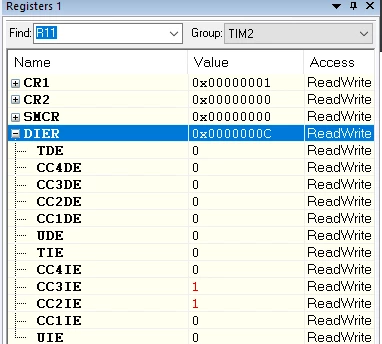

So I just started to use stm32f103 MCU that I have but for some reason I code doesn't go into the TIM2_IRQHandler.

> I can't get the TIM exception to work
And what are exactly the symptoms? GPIO does not toggle? That might mean several things - timer does not run, timer runs but interrupt does not fire in NVIC, interrupt fires but does not run the ISR handler (e.g. if it is not correctly put in the vector table); code may even hang in the startup code. You need to distinguish them.
Use disassembler to check the ISR address is properly set in the vector table. Use debugger, read out and check the TIM2 registers. Make sure TIM2->CNT changes.

With this line:
str R1,[R0,0x0C] //enable the interrupt || TIM2_DIER
You have set the CC2IE & CC3IE, but it seems you have not write any value in TIM2->CCR2.
I suggest that you active the UIE (TIM2 update interrupt) and see if the it trigger TIM2_IRQHandler at TIM2 counter rollover.
FEkic
FEkicAuthor
Jul 10, 2019 6:46 PM UTC
I checked and the code does set the UIE bit

  1. ldr R0,=TIM2
  2. mov R1,0b00
  3. str R0,[R0,0x10]
Should be STR R1,[R0,0x10] ; TIM_SR, and done earlier so it clears the pipeline before the tail-chain test
