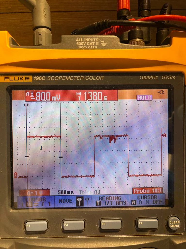

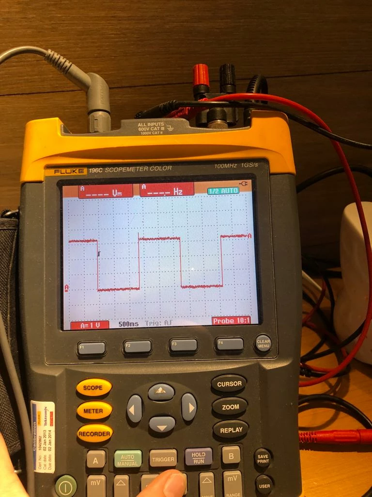

I have tried, I have the same problem. I have configure an output to see the timer, the toggle is set at 1000 ms, I can see that there is still a delay for about 30%. Please see the pictures below.

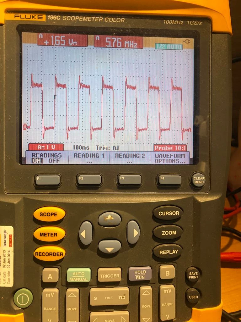

If you want you can do it by CubeMX.
First create a new project in CubeMX. Then , in RCC tab under System Core, check the box "Master Clock Output" (to enable the MCO pin).
After that, go to Clock Configuration, on MCO source Mux, please select HSI source. You should see that PA8 configuring as RCC_MCO.
After generating the code, HSI will be available on PA8. You can display it on oscilloscope and measure the frequency.

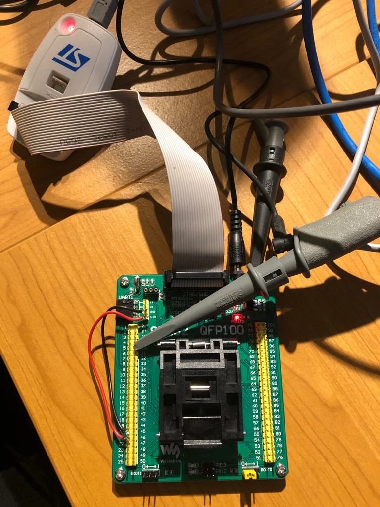

Thanks for your reply. I have tested the project with CubeMX, the probe of the oscilloscope is on the PIN PA8, it seems that the frequency HSI is 5.75MHz instead 8Mhz, the same error that my personal code.
I will try to found a old same mcu buy few year ago to do a compare.

In your code :
htim6.Init.Prescaler = (uint32_t)(SYSTEM_CLOCK_ALFANO / 10000) - 1;				// (uint32_t)(SystemCoreClock / 10Khz) -
//permet davoir le timer avec une base de temps de 0.0001 seconde
This is not right: as SYSTEM_CLOCK_ALFANO is 8000000, you get 800Hz, not 1000Hz
As you get 1.38s instreed of 1.25s I thing your HSI is 7250000 Hz.
Bonne journée!
