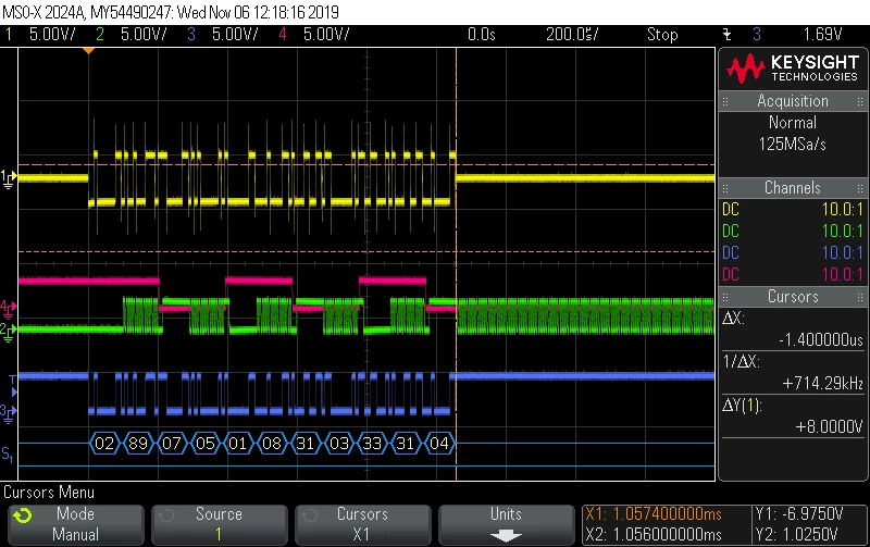

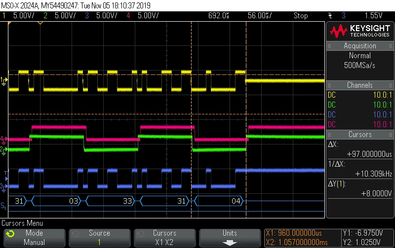

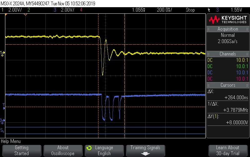

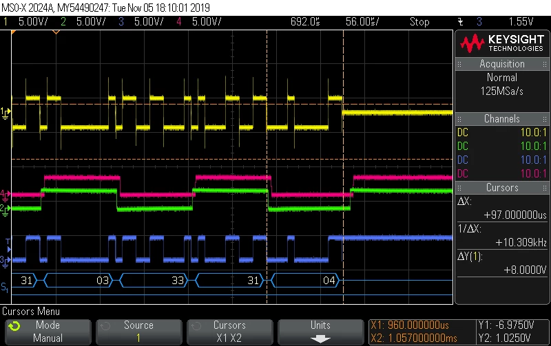

Below you see the screenshot of Yellow: RS485 bus, Blue: The RX Line on the MCU.
This is a 115200 Baudrate, Even Parity, 1 Stop Bit, 8 bit communication.

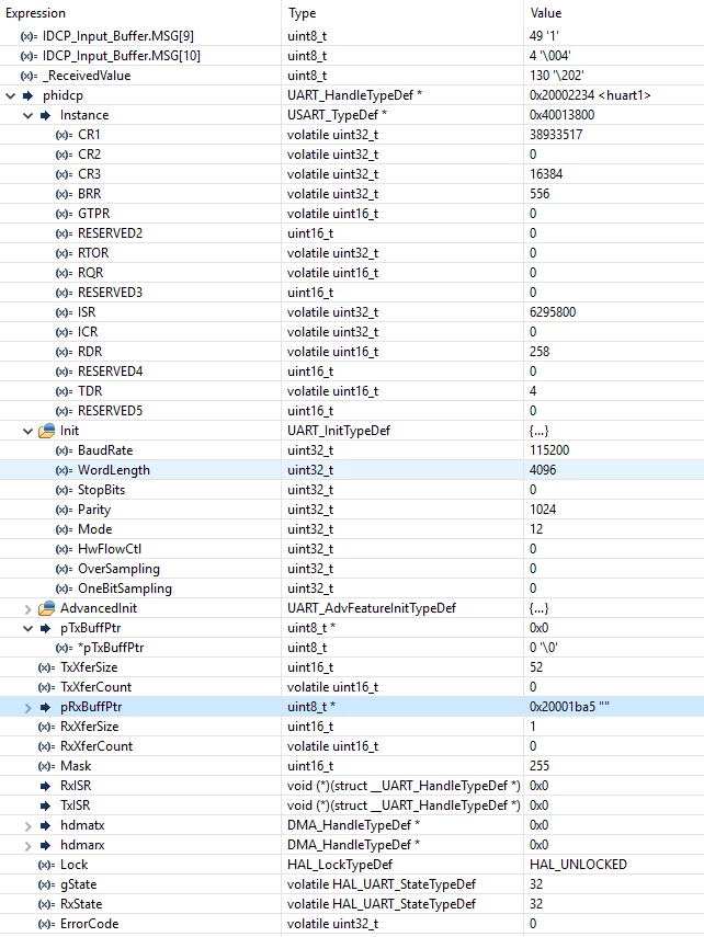

All the bytes are translated correctly every time (10mil messages exchanged) BUT the very last one sometimes it is not interpreted correctly.
You see that the oscilloscope finds this message as 0x04 or 0b00100000.
The MCU finds it 0x82 or 0b01000001. I looks like shifted by one bit to the left, including its parity bit.
I consider that this is caused by the glitch at the end of the message.... but if you see this is after the stop bit! So I do not really understand this behavior...

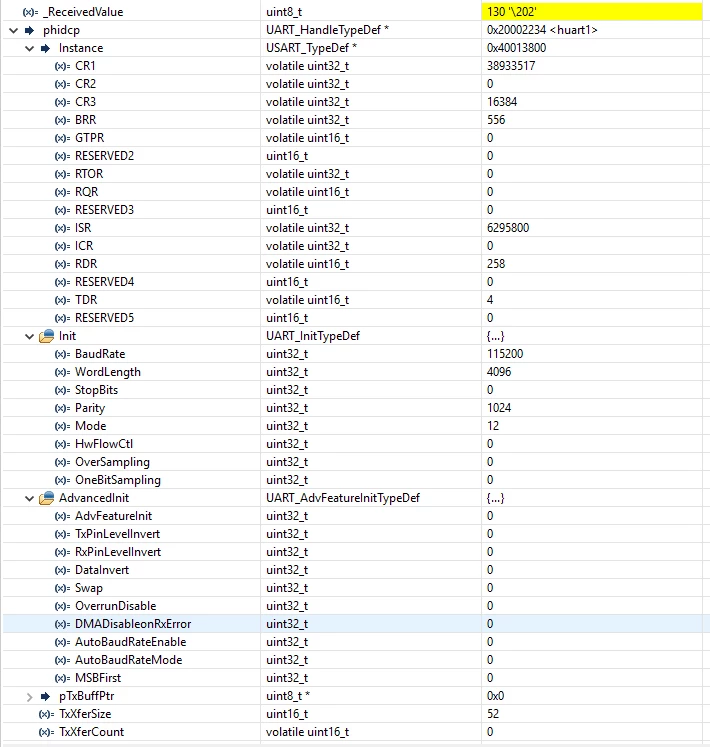

I am not using DMA, this is a byte by byte reading, and a quick interrupt handler.
It is true that the overrun flag is triggered but I cannot really tell why..
This is when the last byte is not received properly
This is when the last byte is received properly.
So my main question is...

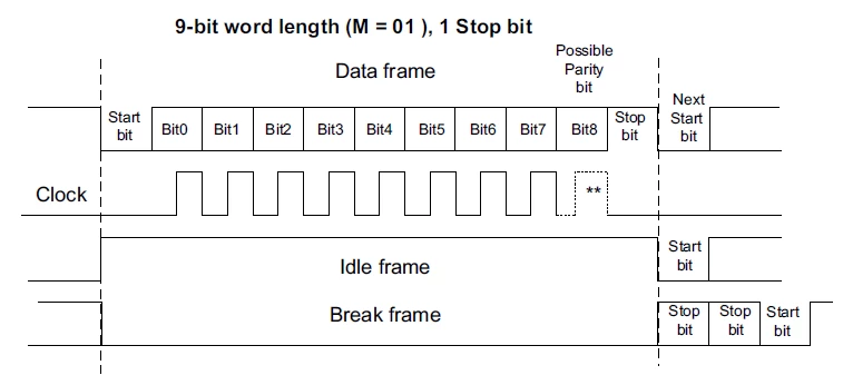

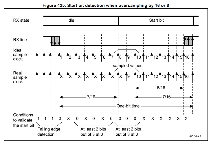

Since this is coming from the datasheet of the MCU:
Why something in the Next Start bit which is clearly not valid is overwriting my message creating an overrun error?

Overrun tends to imply a data byte not extracted quickly enough. Would avoid doing message processing in interrupt/callback.
Review pin state as sampled by processor, look at GPIO IDR, check not seen as oscillating. Set pin with internal pull-up.​
As noted, it looks like you spend too much time in the handler.
Perhaps triggering some elaborate cecks/calculations on receiving a message-end character.

> The Reason that I do not believe has to do with the handler time spent is because when I put the termination resistor I never see this problem again.... and the issue then seems to be related with the glitch. I cannot understand how the glitch can cause an overrun..
Only if the glitch causes the noise to be interpreted as valid frame by the UART peripheral.
Is the cable properly twisted or shielded ?
How long is it ?
A rectangular signal at 112500 bps requires frequency components at least up to 10MHz, thus more then appr. 20cm are already a "long cable".

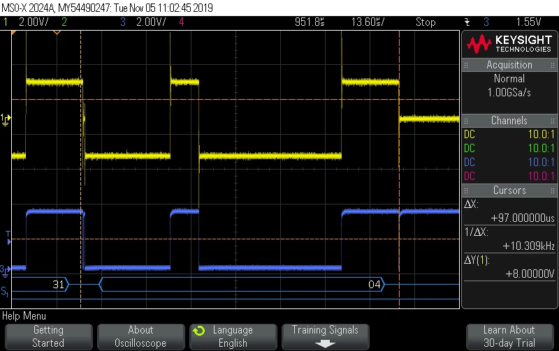

My Question how can it be any valid frame if the graph below is showing the following0690X00000ArhCkQAJ.png
The Glitch Duration is as shown below:
This is 264ns.... the duration of each oversampling 16 is already double 562ns and it needs to find a few to identify this is an actual start bit...
Am I seeing something wrong here?

Some Additional Information.
I added two debug Points for the Interrupts ( Green & Pink Signals )
Yellow: The RS485 Bus
Green: void USART1_IRQHandler_TX_RX(void)
Pink: void HAL_UART_RxCpltCallback(UART_HandleTypeDef* huart)
Blue: Rx
Scenario with the glich[Problem on Last Measurement]
Scenario without the glich[Correct Information]
What you can see over here is that the interrupt when I have a glich is happening much later than when there is no glich.
I want to believe that there is a configuration I have is wrong but for the moment I do not know where shall I look into.
The Start Bit, the Data the Parity and the Stop Bit are all there and there is a glich ... so why the original message is shifted? Looks like the timing is not very well respected or I do not understand something in the manual.

What else could be causing a service delay in the IRQ Handler firing? Interrupt for ORE or NE rather than RXNE? If the USART has a FIFO make sure to loop to ensure it is empty.
Does look to have a large negative spike on the top trace view.
I've seen line noise generate spurious characters, not sure I've seen overruns.

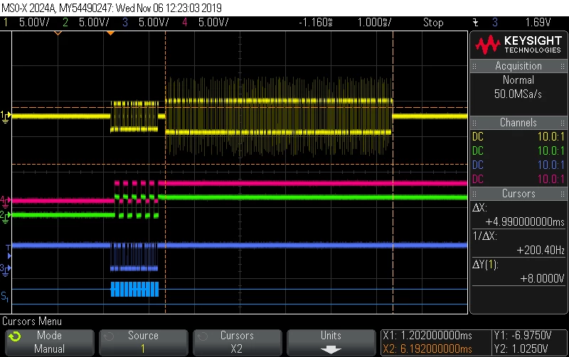

This return message from the MCU was measured 4.99ms
This was a 52 bytes transfered each having 11bits ( Start Bit, 8 bits Info, 1 bit Parity, 1 bit Stop ) + assertion-deassertion time.
Theoretical value was calculated to 4.985us. This gives a 0.1% difference from what it should be.... I cannot believe that this is a problem of the RC.
My question is related to the Interrupt Latency. How is it possible that this glitch can cause a trouble with the the interrupt routine? I cannot see how any other part of the firmware can cause this delay to occur, there is literally nothing running in the background other than the SisTyck with priority 3 that clears the Watchdog.
And how can it sees it as an overrun if there are no more bytes in the line? It misinterpreted the glich to the startbit which does not comply with the graph in the datasheet.

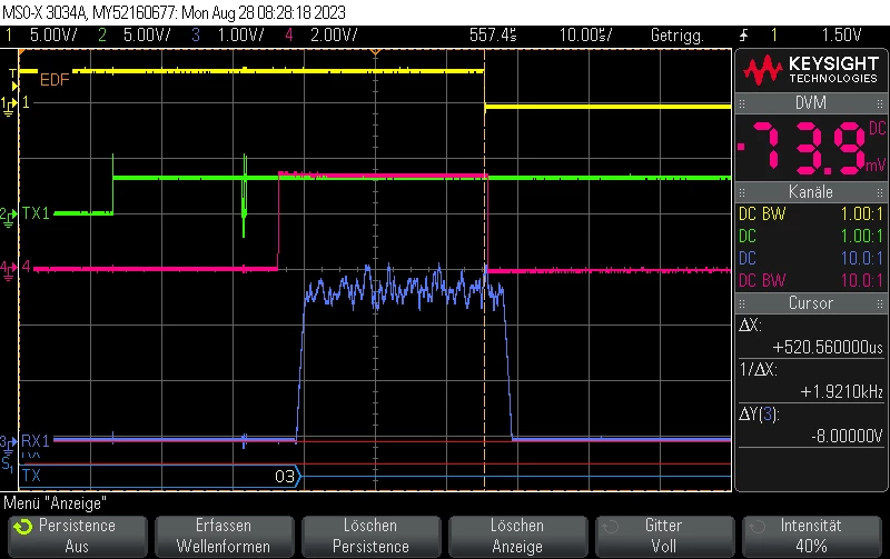

We have exactly the same problem here after we swapped the controller from F103 to L431 on a board. After investigating the problem more closely, we are very sure that it is a problem with the UART/USART peripheral. A short pulse during the stop bit often results in the last byte not being recognized correctly. As a solution for the problem, we change the UART configuration to 0.5 stop bits during reception and to the desired setting during transmission.
We have set up a project that reproduces exactly this error on a NUCLEO L476 board:
https://github.com/DerDan/Stm32L4_UART_Glitch.git
Garnett.Robert
Senior III
September 21, 2023
Have you tried DMA.
I use DMA whenever I process data streams from UARTS and haven't had any issues, although I haven't done any RS485.
I use the modbus timeout feature to signal end of frame for reception.
Regards
Rob.
Visitor II
September 21, 2023
We use DMA in our production code, which is where we first observed the behavior.
We do not use DMA in the project to find the error. In this troubleshooting project, exactly one UART frame is generated using a pattern generator. This one byte is always received. However, sometimes incorrect if the UART frame is disturbed with a glitch within the stop bit. This glitch is created using the pattern generator.
We looked at the generated pattern with the oscilloscope:
However, you can only see the signal around the stop bit.
  • yellow: a signal which is high over the entire UART byte.
  • green: the generated UART byte with the glitch
  • red: high if the glitch at this position resulted in an error (from the previous runs)
  • blue: a statistcal represtation via DAC (from the previous runs)
Based on the investigations we have carried out, we are absolutely certain that there is a bug in the USART/UART Peripheral
