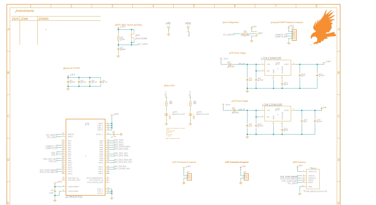

HI there,  I have rewitten this simple piece of code from scratch multiple times with no success. I am just attempting to turn on a set of LEDs.  First in the While Loop. Second in the interupt handler for TIM2.  The chip is a STM32F411CCU in a homespun board.

Provide schematic for what you actually built
Make sure BOOT0 is pulled low.
That VCAP pins have correct capacitors and measure 1.25 V there.
That Analogue supply pins are connected.
SpeedyPLHAuthor
December 23, 2023
HI TEsla, Ascha,
Here is the relevant part of the Schematic.  It is basically the STM32 chip, an FT201 on i2c, and a couple of test sensors on i2c.  I dont have any i2c elements enabled at the moment as I am trying to narrow the problem down.
I am using an STLink/V2 to connect.
I have had it working on a number of occasions.  But it has been very unreliable.
It successfully programmes it.  If I debug it (F6), it will die at  HAL_TIM_Base_Start_IT. If I Step into that function (F5), it will complete succesfully, but then dies on the next instruction HAL_GPIO_TogglePin.  I cant work it out.

Here are the three most common sources of error on your PCB.
1. bad decoupling
2. poorly soldered connections
3. power supply with high noise or unstable under load
And, I think NRST pin should have a capacitor to GND. Usualy 100nF.

Since you've said it's a homespun PCB, I recommend testing the PCB. YOu can test it with a multimeter or make a PCB tester like this.
