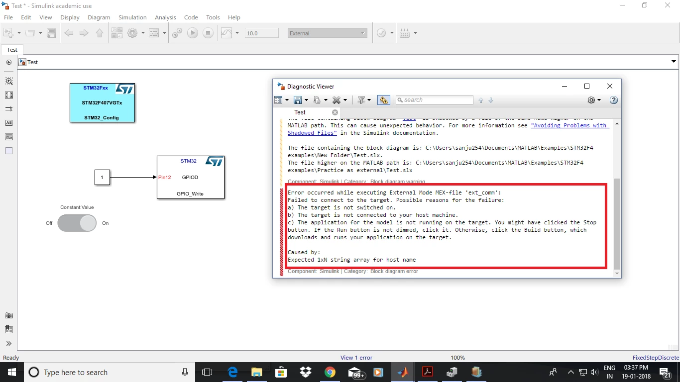

hello i am using STM32_Mat_target 4.4.2 but i am not able to communicate my board stm32f407vg externally i am getting error for connection any one please help me regarding this

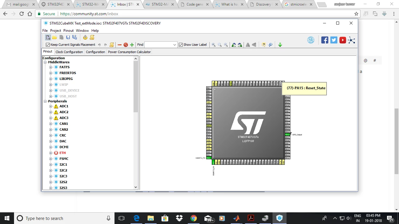

    Here i attach the error am getting and i followed the step as per the manual. can u please suggest me what exactly happening. also please tell a configuration required for this. her i attached configuration of cubemx also. you help is more appreciated.

    The error message gives you 3 possible causes for the problem - have you checked each one?
    Please give full details.
