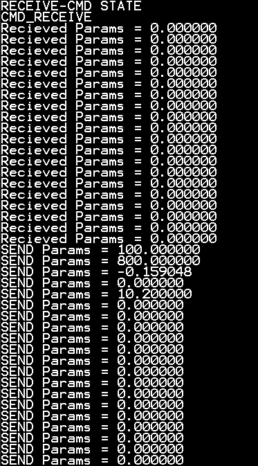

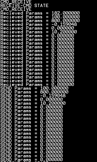

in my application I use stm32F407G-DISC1 as a slave. I want to use the board the spi slave full duplexes. the problem is on the first Receive I get all the data from the master then I send data and works but the second time I only get zeros even though I send data from the master.

Output to Serial Monitor

There are several generations of spi.
I use spi that has 32 bit fifos, dma in cyclic mode, and exti on nss rise edge to process data packets.
When nss goes up, the dma already filled the fifo... you need to rcc/sys reset spi and reconfigure to flush the fifo. There maybe other ways that I don't recall. Let me know if this makes you progress.
And yes, you csn EXTI on alternate function, even if the HAL doesn't....
