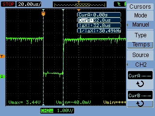

    Review the pin state with a scope when you use NVIC_SystemReset()

    Find below, the pin state when I execute NVIC_SystemReset()
    The reset pin is tied to 0V during 33µs.

    I've only seen this fail when the NRST pin doesn't pulse low. Check the low time on the DISCO/NUCLEO test. The chip is supposed to generate a sufficiently long pulse. Make sure there isn't too much capacitance on the pin.
