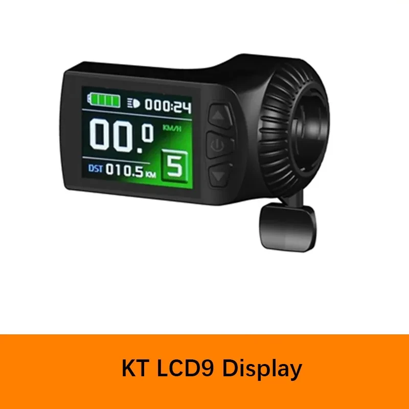

Hi, have any of you communicated with a display based on the ST7735S controller?
Based on this library: https://github.com/afiskon/stm32-st7735  I converted it from SPI communication to 8080 parallel control, but display does not work properly, while filling the screen with color works, writing text,  drawing pixels or squares does not, everything is visible in the video in attachment.
Below link to my project:
https://github.com/apaczenko1993/KTLCD9
Thanks for help.

MSzła.1
MSzła.1Author
Aug 24, 2024 5:31 PM UTC
I can't use SPI because the PCB is from an ebike computer. Exactly from the photo. They use the 8080 parallel interface to communicate with LCD

MSzła.1
MSzła.1AuthorBest answer
Aug 24, 2024 7:57 PM UTC
OK, now the library works, the cause of this problem was that I forgot setup the RDX pin (read enable). After setting this pin as in the datasheet when writing data and commands the library works very well. About
Tomorrow I will upload the project to Github for everyone :)
