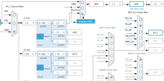

I have noticed that changing the value of D2PPRE2 in cubemx directly affects the frequency of DMA interrupts
Edit: also removing DMA and using interrupts I still get 1/3 the I2S clock speed I configured cube for but can't immediately spot any issues with the initialisation code. This is very fustrating given it worked fine on the F407.
waclawek.jan
October 26, 2020
> 15.42 kHz WS, expected 48 kHz (correct on F407)
> 1 MHz I2S data clock, expected 3.067 MHz
> Interrupt calls for stream0 and stream1 varying between 170 kHz to 210 kHz
This has to be WS/[buffer halfsize] so something is very broken.
Check your clocks settings. Read out and check/post relevant I2S/DMAMUX/DMA registers content. Make sure the ISRs properly clear the interrupt sources. Using Cube is no excuse, it's your code now.
JOatl
JOatlAuthor
October 26, 2020
So two issues (1) when I enabled the HSE for the I2s PLL I took its default cube value of 25 MHz when it should have been 8 which explains the 1/3 speeds. (2) I am still getting DMA interrupts constantly firing - rate dependent upon D2PPRE2 setting which I believe indicates that it must constantly feel it has data / is ready for more. Will have a look at the registers content tomorrow, thanks so far.

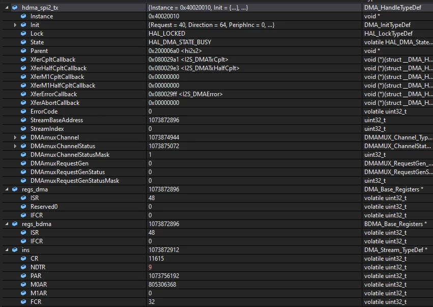

I have set up a new project using cubemx with only I2S2 in master half-duplex in attempt to simplify / isolate the issues I am seeing. With caches enabled, txBuf in D2 RAM and the circular DMA started using:
SCB_CleanDCache_by_Addr((uint32_t*)(((uint32_t)txBuf) & ~(uint32_t)0x1F), sizeof(txBuf));
	HAL_I2S_Transmit_DMA(&hi2s2, &txBuf[0], 64);
I am still experiencing DMA DMA1_Stream0_IRQHandler immediately re-entering (only calling HAL_DMA_IRQHandler(&hdma_spi2_tx); inside the IRQ).
I have a voltatile flag that triggers a call to main code to clean the cache after every TX complete callback.
Here are the DMA initialisation properties (HAL) for the H7:
hdma_spi2_tx.Instance = DMA1_Stream0;
 hdma_spi2_tx.Init.Request = DMA_REQUEST_SPI2_TX;
 hdma_spi2_tx.Init.Direction = DMA_MEMORY_TO_PERIPH;
 hdma_spi2_tx.Init.PeriphInc = DMA_PINC_DISABLE;
 hdma_spi2_tx.Init.MemInc = DMA_MINC_ENABLE;
 hdma_spi2_tx.Init.PeriphDataAlignment = DMA_PDATAALIGN_HALFWORD;
 hdma_spi2_tx.Init.MemDataAlignment = DMA_MDATAALIGN_HALFWORD;
 hdma_spi2_tx.Init.Mode = DMA_CIRCULAR;
 hdma_spi2_tx.Init.Priority = DMA_PRIORITY_LOW;
 hdma_spi2_tx.Init.FIFOMode = DMA_FIFOMODE_DISABLE;
And then for my working STM32F407:
hdma_spi2_tx.Instance = DMA1_Stream4;
 hdma_spi2_tx.Init.Channel = DMA_CHANNEL_0;
I have noticed within DMA1_Stream0_IRQHandler for the STM32H7 if I look at the data under hdma_spi2_tx.Instance address I can see FCR register flag intermittently set to DMA_SxFCR_FS_2, this does not happen on the F407. All other regs are the same.
Here are the registers I was observing (before and after HAL_DMA_IRQHandler I see FCR have intermittently 0x20, FIFO empty)
waclawek.jan
November 2, 2020
How do you know it's immediate?
Do you toggle a pin to observe the interrupt entry/exit, comparing to the I2S stream?
JOatl
JOatlAuthor
November 6, 2020
Setting a pin on ISR entry and resetting it on ISR exit. The pin ends up outputing a signal at around 200 kHz, the speed of this signal is proportional to the D2PPRE2 clock rate
waclawek.jan
November 6, 2020
As I've said above
What's the fill of the signal, i.e. what percentage of time is spent in the ISR?
Find out why does it interrupt so often. Strip down the program to absolute minimum to avoid any interference from other parts; maybe better, start a new minimum project, with only the single I2S.
