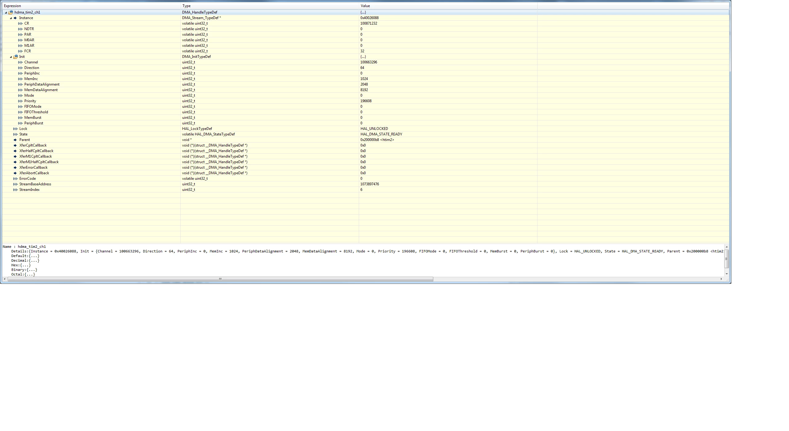

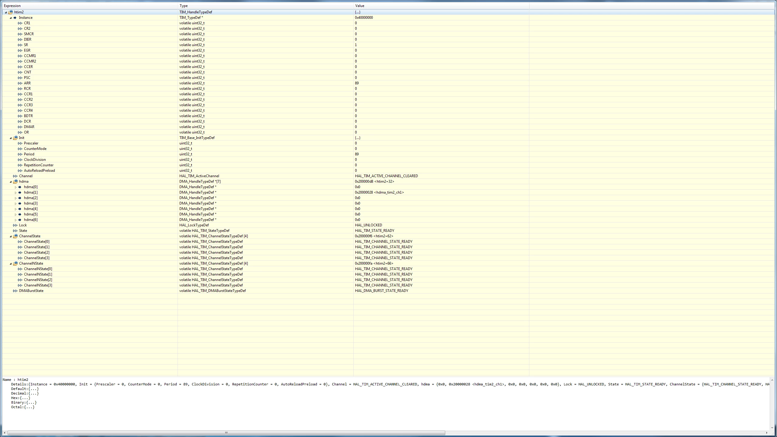

waclawek.jan
November 8, 2021
Read out and check/post TIM, DMA and relevant GPIO registers content.
November 8, 2021
> sConfigOC.OCMode = TIM_OCMODE_TIMING;
You haven't configured the channel in PWM mode. If you want a PWM signal, you need to set it to TIM_OCMODE_PWM1 mode.

DalOpez
DalOpezAuthor
November 8, 2021
I hope I understood you correctly0693W00000GWntXQAT.png0693W00000GWntDQAT.png
waclawek.jan
November 8, 2021
I meant, after calling every functions which set the registers - do it for example when program is in the final empty while().
And add readout of relevant GPIO registers, too.
And make the register values be displayed in hexadecimal.
I don't use Cube.
