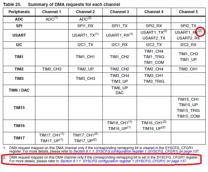

RM0008 is NOT the controlling document for the STM32F0xx parts, that would be RM0091
For DMA1 Channel5 you'd need to change the DMA mapping in SYSCFG, normally I believe it would be DMA1 Channel3

According to reference manual for f0xx, chanels 4 and 5 can also be used for USART1.
Yes, but repeating : For DMA1 Channel5 you'd need to change the DMA mapping in SYSCFG, normally I believe it would be DMA1 Channel3
/* Enable SYSCFG clock */
RCC_APB2PeriphClockCmd(RCC_APB2Periph_SYSCFG, ENABLE);
/* @arg SYSCFG_DMARemap_USART1Rx: Remap USART1 Rx DMA requests from channel3 to channel5 */
SYSCFG_DMAChannelRemapConfig(SYSCFG_DMARemap_USART1Rx, ENABLE);

Posted on October 20, 2013 at 15:06
